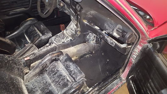

    A few weeks ago while I was driving there was a short behind the dash which started a fire. I pulled over and the fire burned behind the dash for about 3-5 minutes. Lots of smoke and melted plastic. So, the car is totaled and I am trying see if it is possible to bring her back to life.
    The damage is not terrible but the engine wiring harness where it connects to the ECU is partially burned and all other wiring under the dash is damaged. I am not worried at all about the cosmetic damage. I just want to be able to drive it again. Nothing forward of the firewall was damaged.

          I have not opened up the dash yet. However, i would suspect the fire was caused by the aftermarket stereo the previous owner installed. There is a ridiculous amount of wiring stuffed behind the dash. The car had sirius XM radio, 6 disc cd changer and aftermarket blue tooth stereo all installed at the same time. lots of random wires.

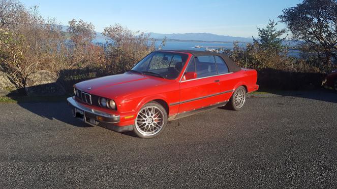

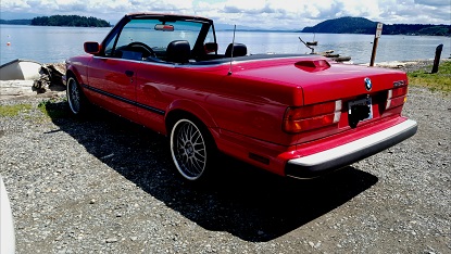

          This is the car in her prime.....

                        Thanks Quadrajet. I am still holding on to a glimmer of hope that I can fix it. I started doing some tear down yesterday. The amount of aftermarket wiring that was crammed in that car is mind bottling. Also, I will definitely have a chat with my insurance company.

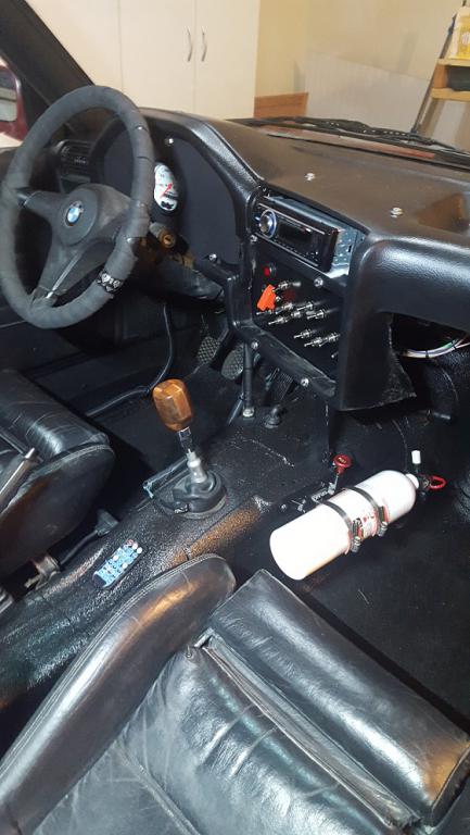

                            Well, it has been about 6 months since the fire and the car is running great! I ended up gutting the entire interior and chassis wiring harness. The only things I put back in were the front/rear seats and the dash. I was able to pull the engine wiring harness and solder/repair any broken or burnt connections. For the chassis wiring harness, I bought an aftermarket one from EZ wiring for about $190 and spliced in any connections that needed to be made. The cluster was burnt as well, so instead of trying to make a used OEM cluster work I decided to run just one gauge. I got a GPS speedometer from Autometer. It was a bit pricey but, it is awesome. Not only does it give accurate speed but, it also is an odometer, trip meter, gives headings, lat long, hours, time, and top speed. I also threw an aftermarket stereo in so I could have some tunes.
                            I removed all the factory carpet and sound deadening. I ended up spraying the interior with bed liner and adding some floor mats from the auto parts store. Also, I threw in a quick release fire extinguisher mount from Drake just in case there are any other fires in my future. After pulling the old wiring harness and sound deadening/heater core the car is about 160 pounds lighter and I can definitely feel it.
                            Thanks again to Quadrajet for helping me out.
