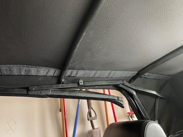

                Almost 2 years later. I finally have a repaired top. The metal frame was bent and ended up breaking and I was able to source another frame, luckily.
                I removed the motors and converted this to a full mechanical top. Just got the top replaced and now on to a bunch of small things plus a fender replacement (driver's side).
