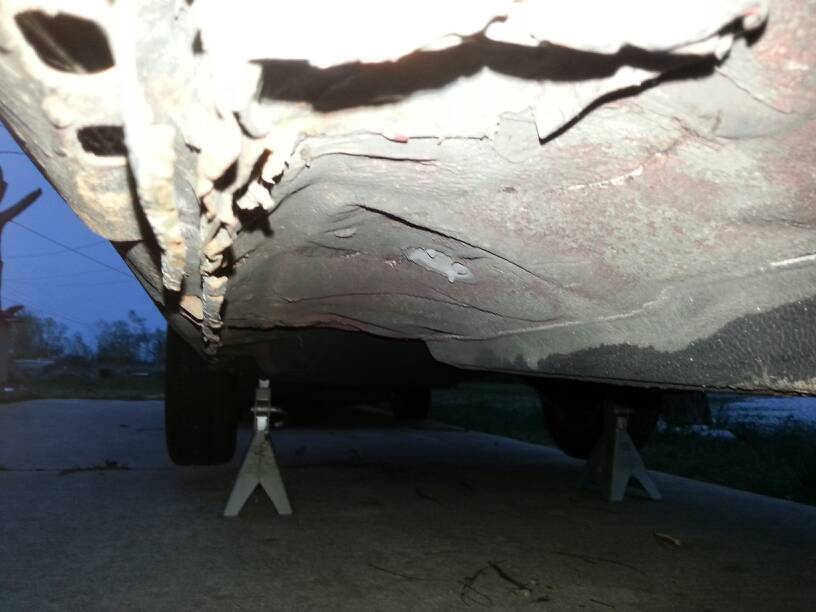

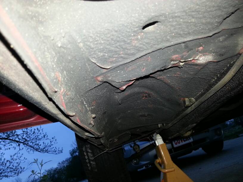

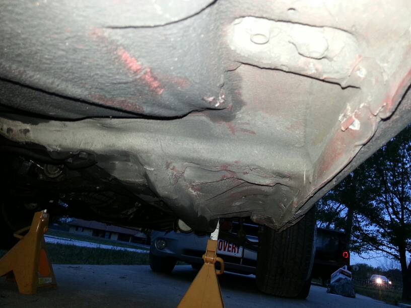

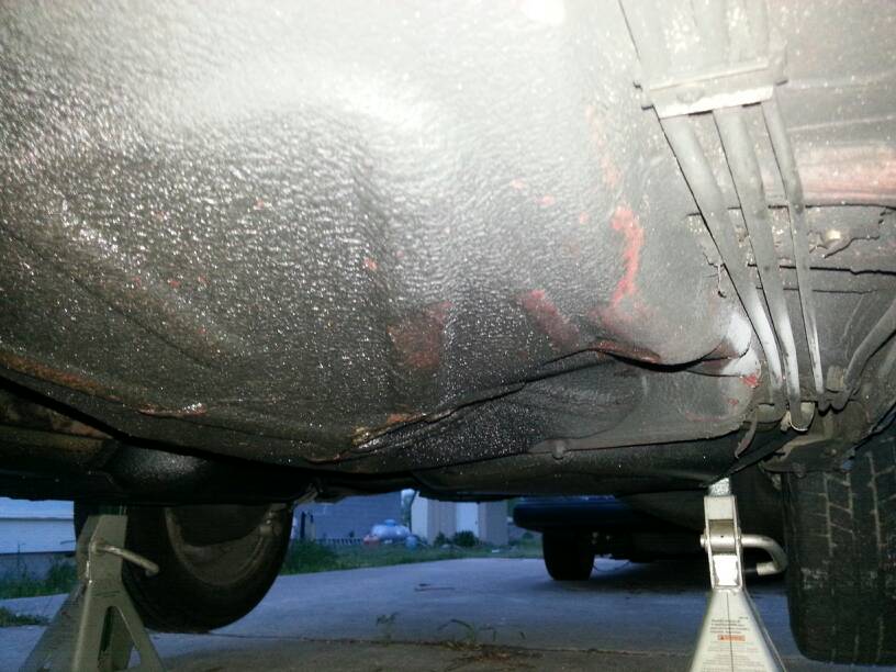

    any pictures of the floor damage? Was there a word on the title status on the car?
    • homegrone30
      • Jun 2007
      • 1449
      #1127
      The title is clean I will try and snap some photos of the floor. On another note me and my buddy are taking our cars to congress for the hot rod round up if anyone feels like joining.
      Sent from my SPH-L710 using Tapatalk
      • homegrone30
        • Jun 2007
        • 1449
        #1128
ID:	7164991Click image for larger version
ID:	7164992Click image for larger version
ID:	7164993Click image for larger version
        • homegrone30
          • Jun 2007
          • 1449
          #1129
          Sorry for the shitty pics its the best I could do with the sun going down and a cell phone. If you want to come check the car out in person just shoot me a pm and ill give you my address. The car is unlocked and on jack stands you could come and look over the whole thing if you want.

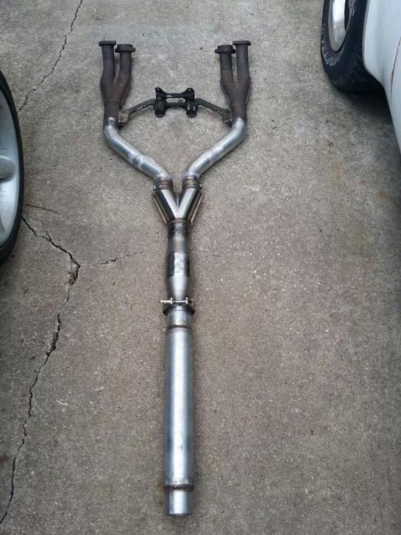

                    Well I finished the front section and part of the catback for the 5er today. Fits great. Just need some new non rusty hardware and to finish the catback I am working on.
                    I cut the stock collectors just behind the first bend, then added 4 2.5 inch aluminized steel 45° mandrel bends, these flow into a SS dual 2.5 inch in single 3 inch out Y-Pipe with 2 O2 sensor ports added, this flows into a high flow 3 inch metallic core cat, I then added a 3 inch V-Band assembly right after the cat, this flows into a 3 inch resonator that is 14 inches long, this then flows into 2 3 inch 45° mandrel bends and through a 3 inch SS magnaflow straight through muffler with a SS tip I added. All TIG welded by me.

                      Very nice

                        Thanks, I welded up the two 3 inch mandrel bends tonight, and welded them to the resonator. Just need to cut one more length of tube to join the rear bends with the muffler. Then I will mark for the rear hangers. Almost done.
