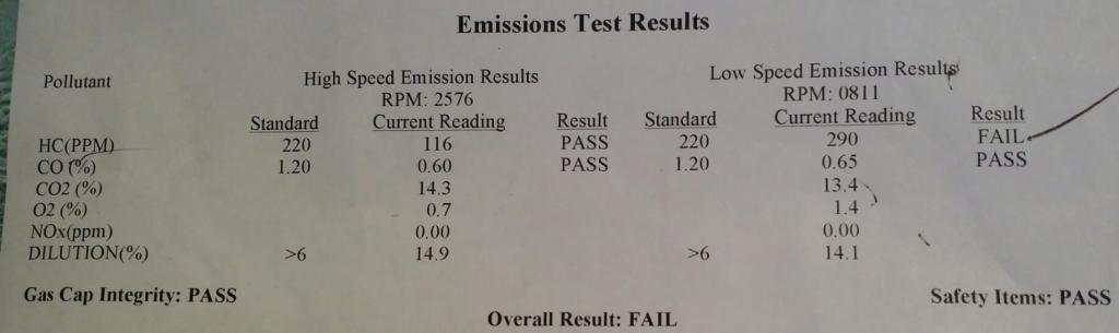

            Failed again. Runs perfect, no dash lights. Idles great. Passes all other parameters by a large margin.
            Hydrocarbons - 290 ppm with a 220 ppm limit, 800 rpm.
            I guess I need to find someone who will pass it for cash.

              Have you done any kind of tune up? Plugs, filters? Stuff like that. It seems like your car wants to pass its just not getting a complete burn. Does it have anything like oversized injectors or a chip or anything? My e30 wouldn't pass but I was also running oversize injectors on a stock tune.

                #1162
                Just did a full tune up.
                Valve cover gaskets and grommets
                Spark plugs
                Fuel filters
                Air filter
                Oil and filter change
                New water pump
                New thermostat
                New oxygen sensors
                Cleaned idle control valve
                I attached the emissions report.
                I also have a coolant temperature sensor to install when I test the FPR.
                Am I missing anything big?

                    #1164
                    Temp sensor honestly could be what it needs. It could be dumping more fuel then needed due to the computer seeing a colder temp.

                      #1165
                      Fpr could be a suspect as well

                        #1166
                        Well the coolant temp sensor is installed. Just need to test the FPR, other than that I am at a loss. It runs and sounds great, has nice throttle response, with a rock steady idle, and not a puff of smoke, fixed all the leaks too...
