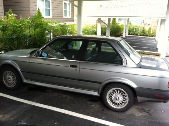

    ok.. sorry for all the question threads, but i am not the smartest car guy, not even close. and unless the search feature offers a exact answer, i need help.
    Can someone dumb down for me what exactly i would need to do to run some ESM bbs reps (16x 7.5 4x100 et38 ) safely without ruining anything on my car.
    few things
    • I dont know what centerbore is at all?
    • i also hardly know what offset really is. I know my IX weaves are ET 41 and those are 38, which seems close? would spacers fix that?
    • Will i have problems running these wheels due to the fender flares? I plan on lowering the car in the near future but not by much at all ( that will be my next thread ;) )
    thanks alot guys, i really want to get this car right for the summer! and keep my ix weaves for winter wheels.

    those will fit directly. they're ET35, which is about perfect for a 7.5" wheel on the ix. You can choose 51.7mm, 16x7.5, ET35 when you add them to your cart..
    don't worry about spacers. stock fitment is *extremely* conservative. also, spacers would lower the offset, not increase it. There's a chance you may need a tiny spacer (3mm) to clear the brake calipers up front (not because of ix, but because of E30 - all E30 4-lug front brakes are the same). They'd still fit fine at ET32 effective offset.
    you should easily be able to fit a 215 or 225 tire on there, with a 40 or 45 sidewall. or a 235 r-comp if you're feeling adventurous. ;)

      Exactly what i was looking for! thanks NANDO you are the man. You should see me cruising around bellingham soon.
