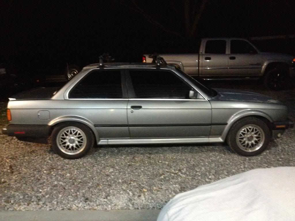

          asteliff -- these are 17x7.5 et35 with 215/40. No fitment problems, but clearance is just about maxed out in the back. I'm lowered on H&R sports.

                  I don't have a lot of pics of my wheel setup...so let me know specifically what you'd like to see and I'll take some photos.
                    jP4- Thank you. They look to fit really well, I'd have about a quarter of an inch on either side due to the 7 vs 7.5" width. I think they will be perfect.
