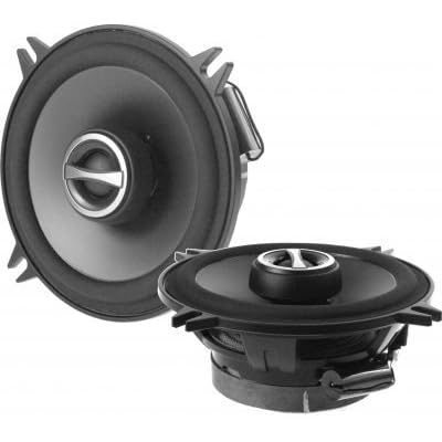

    Front Speakers-Alpine 5.25 type R spr-50c
    Rear speakers-Alpine SPS-510 5.25"

    Hard to tell but got the new tweeters to fit in the original location.
