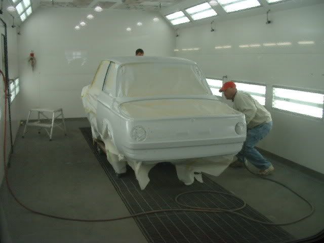

    the entire car including hood and trunk received standox spray filler. the quality of the mobile traditions panels are less than desirable and in order to get panels like glass it needed quite a bit of work and hours and hours of blocking. here it is receiving the spray filler

    they painted the trunk , engine bay and jambs and then went on strike. my car sat idle for 4 weeks until they finally settled and got back to work on monday. heres a few of them prepping the outside. i went with colorado and got a ration of shit for my color choice. it was common to hear "you put all that money into that thing and youre going to paint it that color"???
    but once the color went on it they all changed their tune. it now has 4 coats of base color and 2 coats of clear. then they sanded the clear and applied 2 more coats. i havent seen the final product yet but it sure looked good after the first 2 coats of clear.
    these pics are shots of the base color only. no clear applied. i didnt have my camera with later in the day.
    heres the car getting the initial clear sanded. you can get a general idea of what the colors going to look like on the paper.
    and heres karl the painter. hes treating it as if it were his own. i really like the guys at sears imported autos. its my local bmw dealership and ive made a few connections there over the years from selling parts etc.
