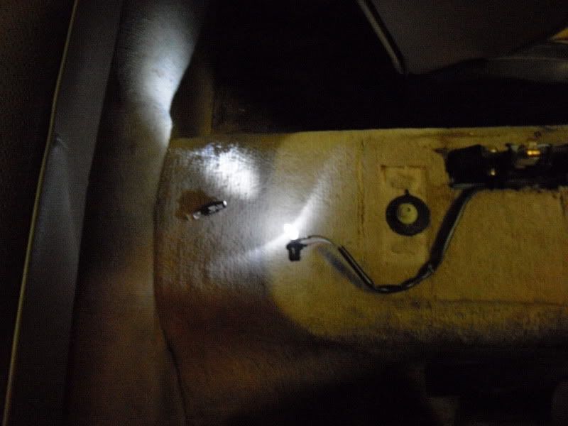

                            Since I have the console and seats out I decided to go through and repair all the burned out bulbs inside the car.Both OBC (6bttn) were gone as were the selector indicator light and both ash trays. For some reason there is 11.22v going to all of them and I am going to use 5w L.E.D.'s so after some quick math it looks like I am going to need 330ma resistor. Doin work so I never have another dead bulb or the next owner. :devillook

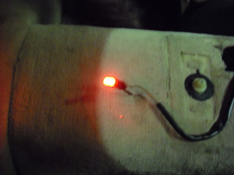

                            Got one done and I broke the light diffuser in the OBC used a white in this one but I think I am going to go back and get all orange.
                            Pics in a minute!
                            I am going back to Affiliated Electronics to get more orange bulbs. The white makes a bright spot in the OBC display. I am either going to use a less intense light, diffuse it with foil and paper, or run two white led's from the side behind the plastic.

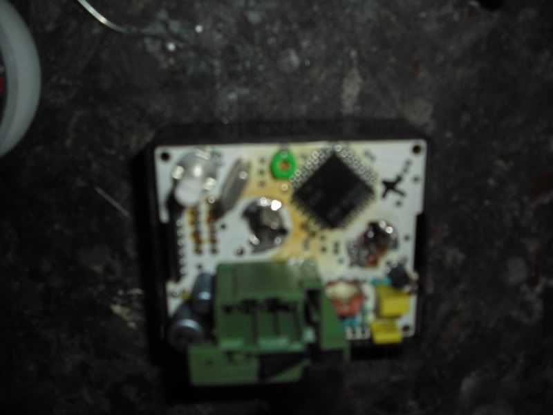

                            With these ancient looking resistors I had a hard time getting the OE OBC bulb sockets to fit, the resistor alone is the size of the old bulb. Tried to take a pic but my wife's camera doesn't like to focus on small up close stuff.
                            Pic of OBC before reassembly:

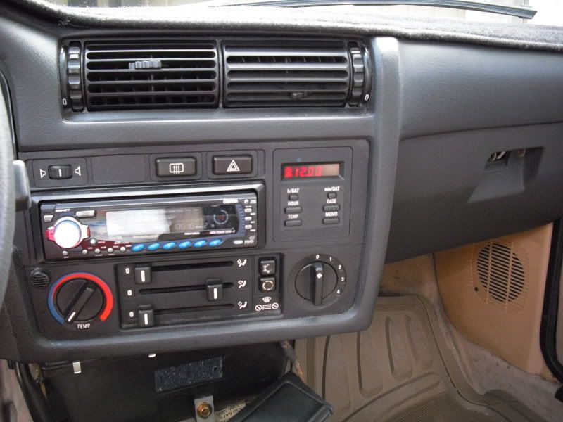

                            Done OBC now on to the ashtray! I ended up going with two orange led's on the sides similar to how the lightbar is on the 16 bttn for the display. It's visible in full sun which is good, couldn't even read it before. FTL
