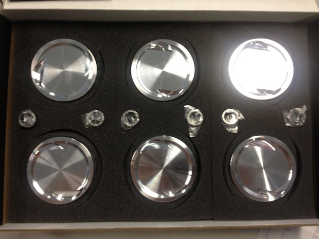

    All items are brand new, and have never been installed. Shoot me a pm, or leave a comment with any questions.

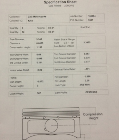

    CP Pistons - m20 - 85mm bore - 8.5:1 compression ratio
    $875.00 shipped
    These pistons are designed for 135mm rods, and an 81mm stroke (m20b27) crank.
    Arguably the best pistons for your 2.7i turbo build.

                    So those Pistons won't work with a b25 crank?
                    Sent from my SAMSUNG-SM-G928A using Tapatalk
                      The pistons are designed to be used with an eta crank, "e" or "i" block bored to 85mm, and an 885 cylinder head.
                        So the pistons are for ETA crank with ETA rods? Do they have piston rings included?
                          No, ETA rods are 130mm. 135mm rods are found in a number of BMW engines including the m20b25 "i" engine.
                          This is what your engine would consist of:
                          • m20 block (cylinders bored to 85mm)
                          • 81mm crank (cast "ETA", or forged diesel)
                          • 135mm rods ("i", s52, etc.)
                          • 885 head
                          • stock "i' or aftermarket cams (valve relief depth is listed on the spec sheet)
