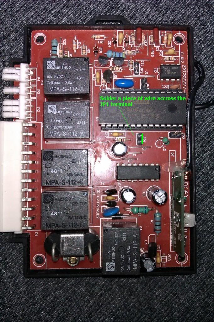

                      It has been brought to my attention that the instructions are a little lacking on how to disable the auto arming when you turn off the car. You will need to open up the control box by removing the 4 screws and physically alter the board. I have ordered shunts and will include them in all future kits. If you already ordered a kit and do not want to solder a wire please let me know and i will mail a shunt out to you.
                      www.gecoils.com

                            hmmm wonder what jumper 4 does ,the jumpers 1,2,3 are in the manual but not jumper 4. im trying to figure out how to make it control interior lights when unlocked??
