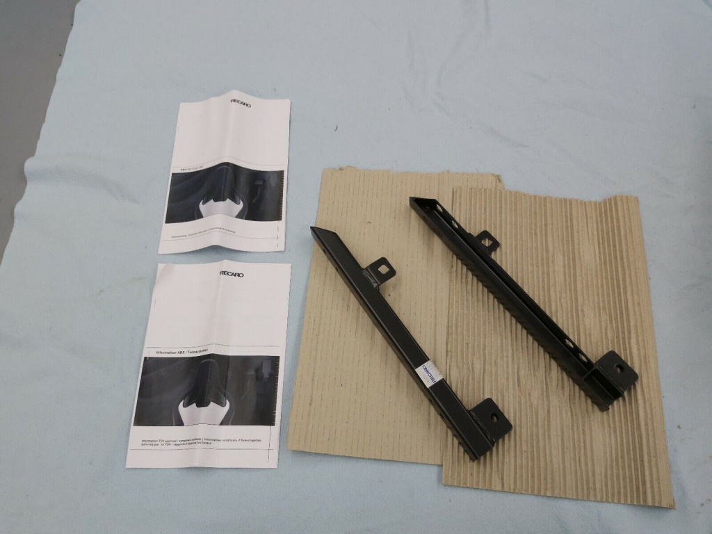

                    Below is a picture of Recaro e30 brackets and how they designed (rear square hole etc) as well as their installation manual. These are sourced from the internet and your brackets are much more affordable that Recaro ones (if one can even find them). I think I can make your brackets work with that center rod and stock rear hole hardware/seat belt receiver. I just wondering if it's worth the trouble and would like to hear your take on Recaro design vs yours.
                    Recaro brackets with the square holes to fit OEM center rod

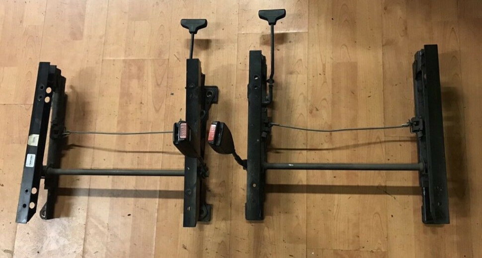

                    Recaro brackets are bolted to OEM e30 sliders.

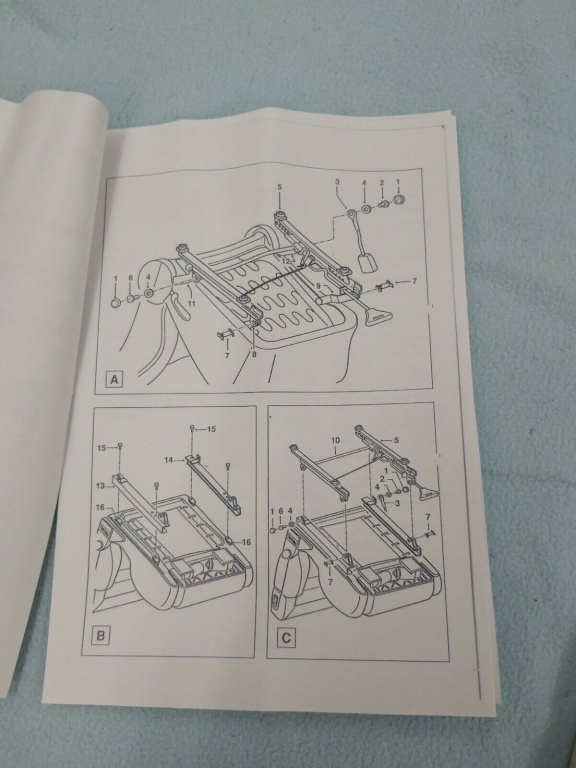

                    Recaro installation manual

                      Bringing this old thread back from the dead as I didn't see it back then. I remember very well the original Recaro Kuyper adapters when I designed Massive seat adapters over 15 years ago. We had discussion on R3V about them. The reason why I didn't impliment a square hole is very simple. It is not needed. Especially that many adjustments are lost when removing the seat assembly and its adjusters from the sliders. The original seat belt receptacle has a lot of flex and will adapt to everyone's seating position. Also, Massive's Recaro adapters were designed to fit not only the OEM sliders, but also solid floor mounts for those tall drivers who want a very low seat position.
                      Back to the seat belt latch, it can be positioned at any angle as it is bolted to the adapters with a 12.9 graded bolt.
