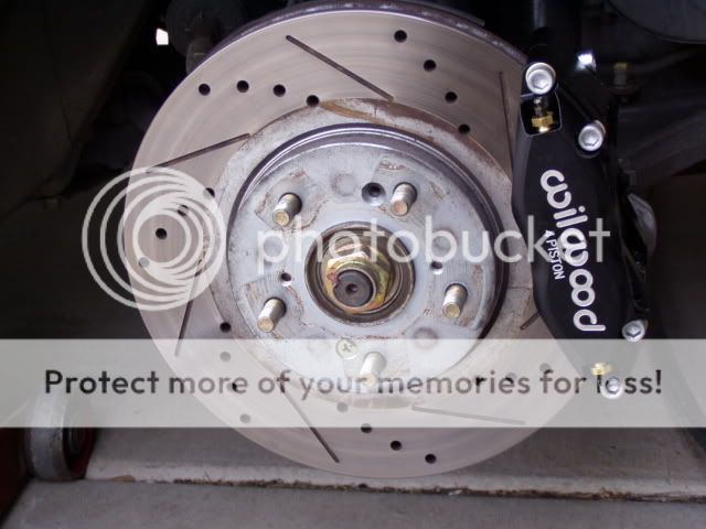

      OK added pics of the calipers. Thanks

        was wondering if you can provide me with part# dynalite and dynapro calipers.
        Basically im tryin to get the diameter of the pistons and the material used alum, stainless, or titaniun on the actual caliper pistons?
        I'm aware the calipers are alum but there are many many piston options among the wilwood lineup. Basically im trying to figure out the volumetric efficiency vs. the kit i presently have.
        Also was wondering the brand, weight, and thickness of the rotors?

            Calipers will have 1.38" pistons, which works well with the stock master cylinder. The total surface area of the caliper pistons is approx 3.00 square inches which is slightly larger than the stock calipers (2.80 inches).
            Dynalites are 120 6805, Dynapro are 120 9702, Dynapro6 are 120 10132, 120 10133.
            Pistons are stainless steel.
            Rotors are usually from Centric, but may be supplied by other wholesalers.
            We typically slot/dimple them and have them zinc plated to prevent rust.
            Rotors weigh 14.5 lbs and are 25mm thick.

                        OK first brackets are made, picking them up tonite to test fit tomorrow. Will take pics of the Dynapro and Dynapro6 caliper fitment on my spare strut, then will test fit on the TRM 15x8 wheel.

                            OK the 11.8" rotor kit with the Dynapro and Dynapro6 calipers won't fit the TRM 15x8 wheels. The caliper touches the inner barrel of the wheel. If they had another 0.25" more room it would work.
                            I might try to move the caliper down another .35 inches and see if that will work...can't get another pair of brackets made for a couple of weeks as the fabricator has another big job to do...
