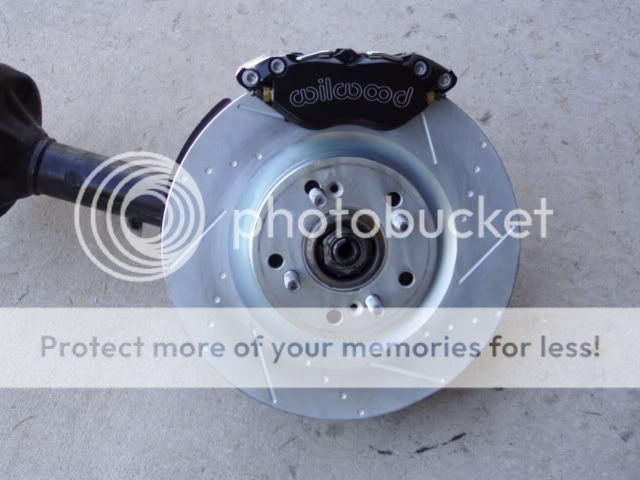

              OK the 11.8" 1 piece rotor kit has been finalized.
              Test fitted it to the TR 15x8 wheel and it just BARELY touches the inner barrel of the wheel.
              If you don't mind shaving the outer edge of a caliper it will fit. 16" and larger wheels should fit OK.
              Pricing has stayed the same, will offer it to forum members for $635 plus shipping.
              Kit will have:
              300mm x 25mm 1 piece rotors
              Wilwood Dynalite calipers
              Wilwood BP20 performance pads
              Mounting brackets and hardware
              Front braided steel brake lines
              Picture shows the Dynapro caliper.

                Any pictures? Have you given up on the rear kit?

                              anything?
                              cause that redrill looks pretty sketch

                                No word back from DBA yet. The redrilled rotors work just fine. I've sold over 1000 sets of rotors with an overlapping hole with 0 issues. The stresses are at a tangent to the hole so any force is directed into the closed part of the hole...
