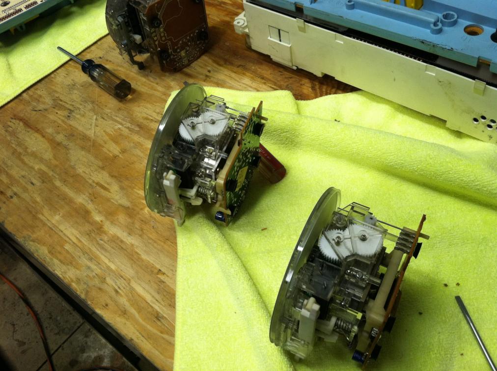

          these are excellent. they work exactly like they should. they are well made and everything fits perfectly. the directions are very clear, concise, and easy to follow. not that you'd need them, it's a simple job. but good directions are always appreciated. almost as much as good products. i honestly think they've done a real service to the e30 community here and i would not hesitate to buy products from them in the future.
          here's a pic of mine and my friends odometer's fixed. all working and 100%.
