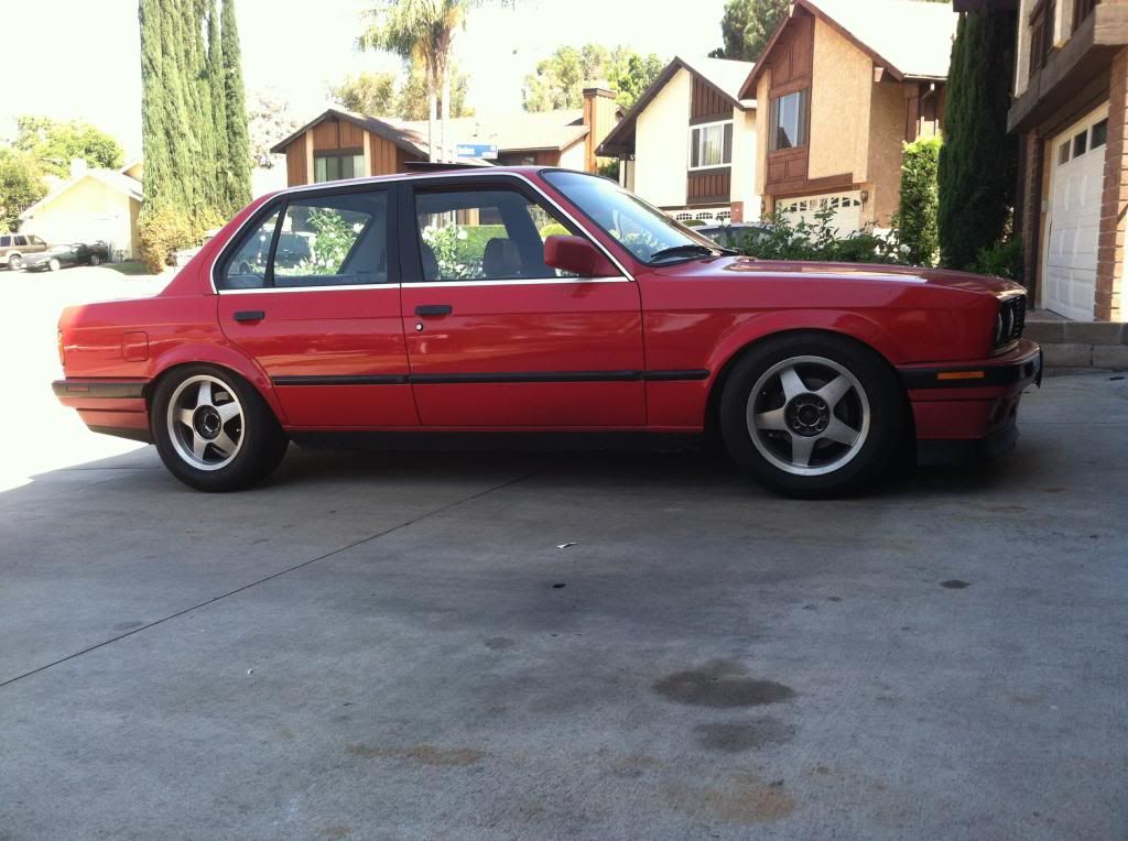

                      my whiip with rears on only. lowest setting. Waiting for struts to come in to put the fronts on. GE coils tho mang....SO SWEEEET
                      [IMG][/IMG]
