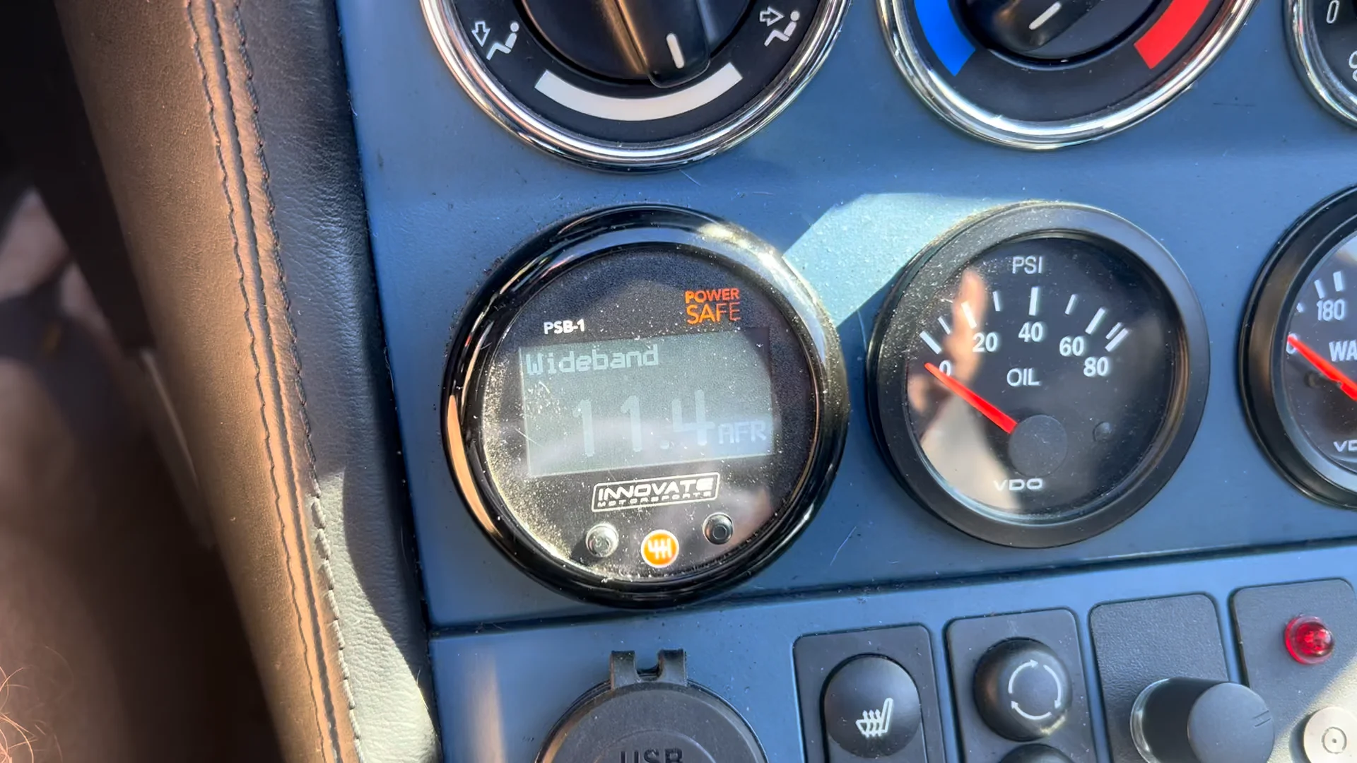

              I have a PSB-1 AFRs are near perfect at high revs (10-11)
              When I first installed it, the sensor was bad, Innovate replaced it.
              This is "IMG_8676" by Jeff Jeffers on Vimeo, the home for high quality videos and the people who love them.
              I have seen 7.7, can't find that picture.
              Click image for larger version  Name:	Screenshot 2024-05-05 at 2.47.50 PM.png Views:	0 Size:	149.5 KB ID:	10119858
              Also, this is a new S52, has under 1k miles. :D
