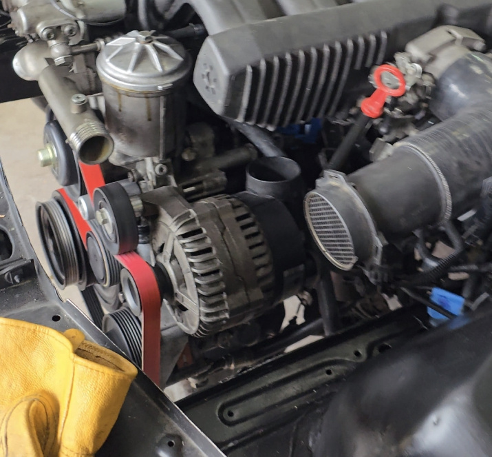

    Do you have the belt routed correctly?
    • Enriquez2000
      • Apr 2024
      • 152
      Poor picture but yes I do
