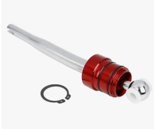

    Putting an M52 into an 87 325is and I cut and rewelded the shift selector rod exactly 10* off from its original position and now I now cannot get into 5th nor reverse.
    The thing I think may be playing part is the AZON short shifter (pictured below) that I am using... and TBH I really don't care for it that much more than OE... and I wanted to find out whether anyone else had the same experience with this shifter installed.
    In addition (and I am not sure it should be this way) the carrier where it through bolts to the B*tch clip does have some wobble left to right... should that be or should it be tight? maybe that's the true culprit or a combined issue...
    but
    If anyone knows whether the 10* twist functions even with an azon short shifter shown below... please let me know...
    and
    if anyone knows where there should hardly be any left right twist play in the carrier at the tranny mount where the b*tch clip goes through... please also let me know.
    The shifter I have installed is...

    That looks like the 'pivot relocate' shifter from UUC and others. If so, then yes, it limits the rotational
    movement of the shifter quite a bit, and I can totally believe that it's not giving enough rotation
    to get a 1:1 5th transmission (especially the Getrag) into the 5 or reverse gates.

      the shift arm should have very minimal play at the bitch clip location. I run delrin bushings to replace the factory rubber bushing there. The shift rod selector joint can also lead to unwanted play in the shifter. it sounds like your problem is with your clearance on the bottom side of the shift lever; the selector rod is coming into contact with the shift arm and/or that red riser piece in your picture. You may be able to modify that to the bolted type short throw instead of the snap ring type in the picture to get the clearance you need for the shifter to go side to side. I believe Turner makes the short throw kit I'm referencing.

        If you only mod the selector rod and not the shift carrier, the carrier will still be offset to the transmission. I could see that 10deg+the raised pivot from this shifter preventing you from getting in reverse (if I'm thinking about this right) but not 5th.
