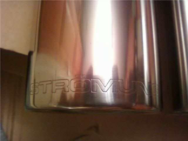

                          Gathering the last bits yet, don't plan on starting it until it's ready to roll, so it's going to be a few more days. In the meantime, here is what showed up today :)

                              • dude8383
                                • Jan 2005
                                • 10387
                                #135
                                Originally posted by MIKe30
                                yowza. gonna hit your thread, see if you cleared it up yet.
                                dude i can't wait to hear the motor with this exhaust. i think i may purchasing a stromung exhaust next summer :)
