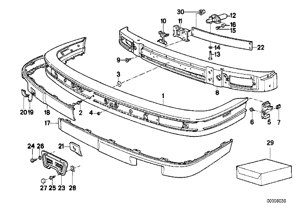

                  • hoveringuy
                    • Dec 2005
                    • 2747
                    I have to admit I'm completely clueless about the euro bumpers. I have the '90 facelift plastic bumpers. I thought those were light. What is it that makes them heavy? How heavy are they? How are the euro bumpers different and how much less do they weigh?

                      Picture this:
                      Hardboiled eggs.
                      Okay, so you break one in half, and check it out. If you cut it exactly in half, you have a yolk, white, and eggshell. That's your typical US "diving board" bumper. Ugly, and heavy.
                      Now take the yolk out. Now it's a little prettier, a little lighter. That's your plastic bumper.
                      Now, scoop the white out. That's your Euro bumper. Just a shell of a bumper. MUCH lighter.

                        I assume the white can't be scooped out of my bumper?
                        • erik325i
                          • Jan 2005
                          • 3567
                          It's possible. You'd have to come up with some clever way of mounting the bumper skin to the car though. The stock bumper cover is mounted to the bumper core (white part) which is bolted to the shocks attached to the car. Without the bumper core, you need to make brackets to mount the skin.
                          Or, if you want to lose some weight and still have the structure of the bumper, get a hole saw and swiss cheese your bumper core.
                            I thought about doing this, but after looking into it for about ~5 minutes, I decided I'd rather spend a few hundred bucks on a set of Euro bumpers and brackets. I prefer the look of the little steel bumpers too, so that was a big factor in my decision.

                              I never thought about just fabbing some lightweight brackets to mount the plastic bumper skin without the support. That would be mighty nice for a track car...

                                I can see from the diagram where the weight comes from, I never thought about what's behind the plastic. #22 should be labeled "ballast" instead of "reinforcement".
