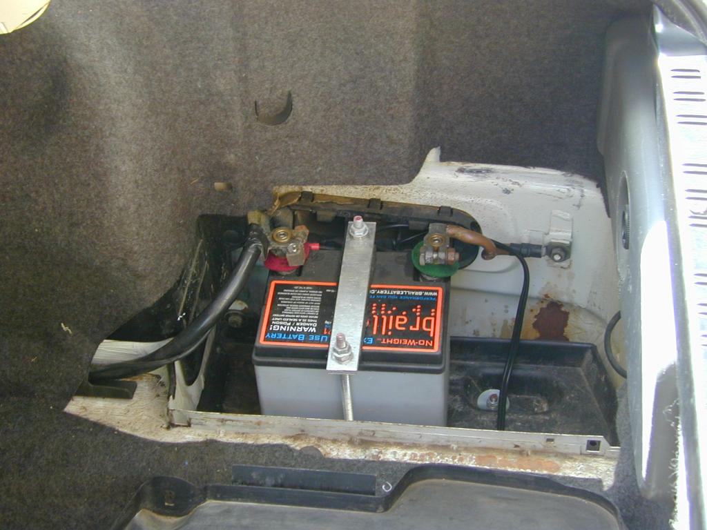

                  89 325is. Nothing removed. 2750lbs, no driver, 1/2 tank, 14" bottles, spare tire. Braille lighweight battery.
