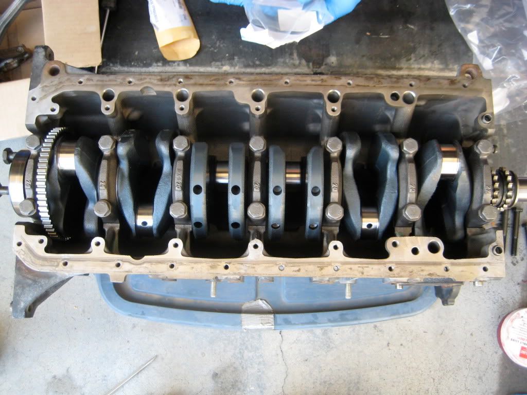

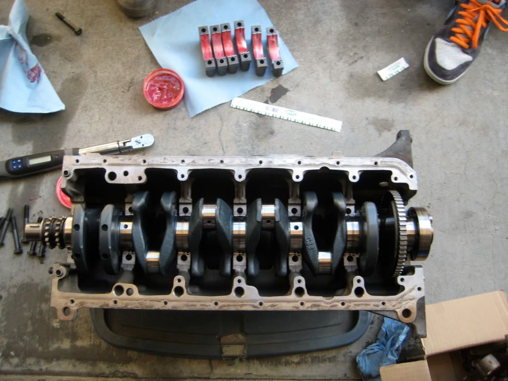

                          update

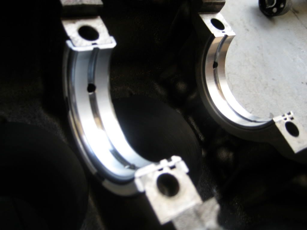

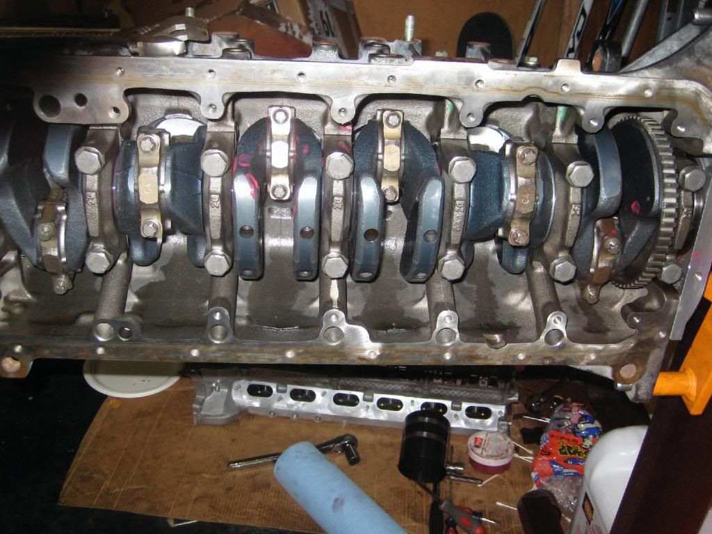

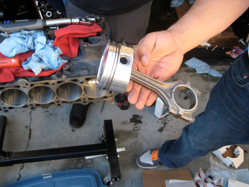

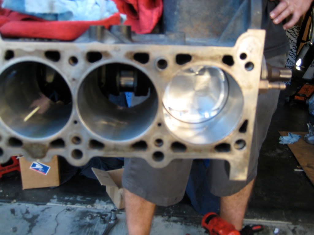

                          Got some work done this weekend with the help of a couple buddies (One being surebimmer). We finished up the shortblock for the most part. Hers's a few pics. Hopefully I'll have enough time next weekend to put the head on and get it all ready to drop in!
                          new bearings starting to go in
                          new bearings
                          crank in
                          crank bolted in
                          piston rings in position ready to go in
                          first piston in
                          rods all bolted in with new bearings
                          all pistons in

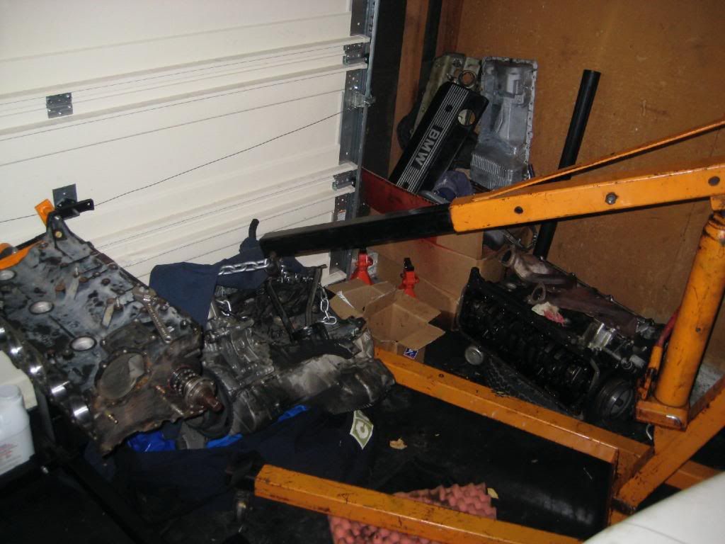

                          messy garage.left to right (s52, s50, m50)

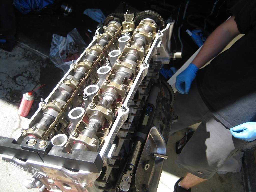

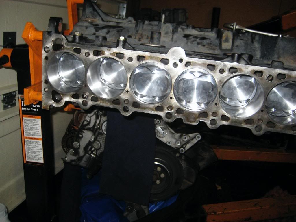

                                update
                                Longblock basically done just need to put on oil filter housing, valve cover, etc.
                                new head gasket
                                head on
                                cam timing/Dr vanos complete
