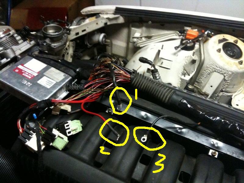

    Alright looks like I may need some help here with wiring the terminal.
    I have a harness that looks completely different than harnesses I've used in the past.
    Im unsure where each of these three wires go.
    I hooked up wire 1 to the terminal and got power in the cabin. When I went to turn the key the starter clicked, but didn't crank.
    I've tried a couple different configurations to no avail.
    Any help would be appreciated.

        #48
        I'm looking on my iPhone so it's hard to see, but it looks like 1 and 3 are brown which means they are ground and 2 should be power.
        88 325is s50 powered
        -Brian
        • briham89
          • 23
          #49
          Come to think of it IIRC #2 hooks up to the fuse box on the e36 and isn't used in the swap. Just ground 1 and 3 and see if that works.
          -Brian

            #50
            Originally posted by ahriley91
            Make sure there is main power to your starter. Ask me how I know. One of my stupid moments of my swap. haha.
            Good man, somehow I missed that.
            Thanks, I tried this too after finding this thread
            So the car is cranking, but I'm not getting fuel. One of the relays on the harness is making a funny noise when the key is in the on position. Even tried jumping the relay and still no fuel. Just in case your wondering the fuel lines aren't switched, I unplugged them and have them in a cup. At this point I'm thinking maybe a bad dme?

                #52
                I'm not up on the obdI swap but if it uses a obdI dme you can borrow mine. I have a silver label 413 with an EWS delete chip.
                Thanks for the offer. I used a buddies red label just 10 min ago and I now have fuel! hooked it up to the front of the manifold (silver supply), but I am not getting spark because it wont fire......
                Im gonna try a different crank sensor real quick....
