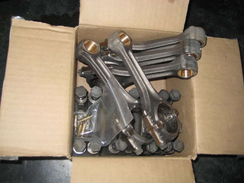

    sharksforthecup s52 11:1 je pistons sunbelts

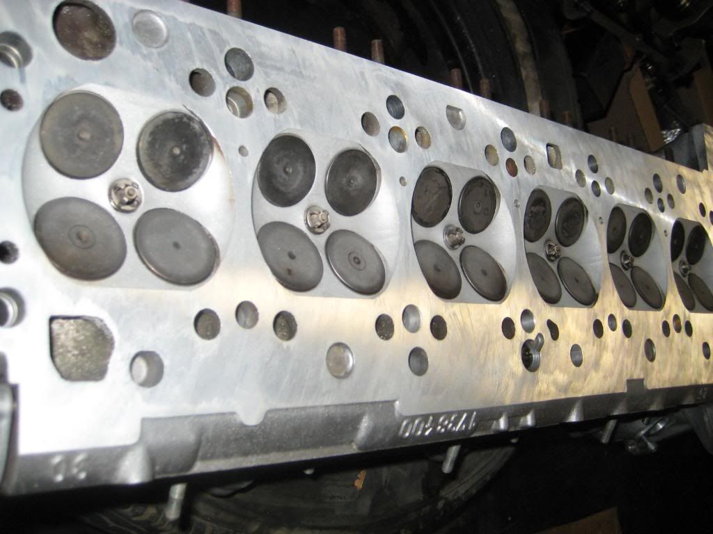

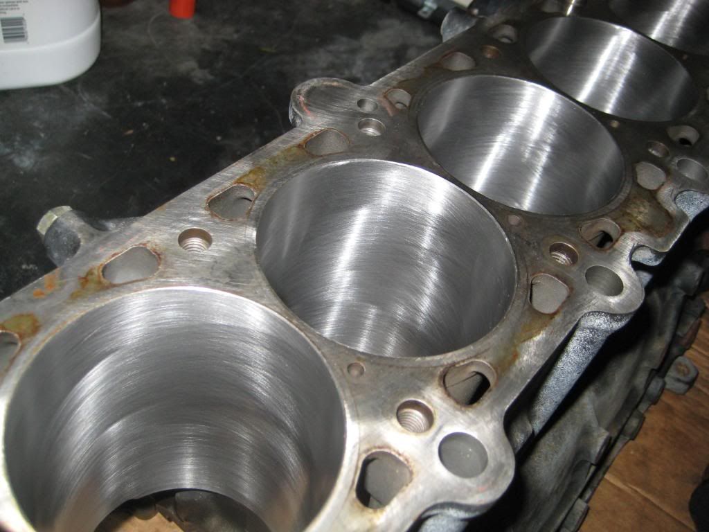

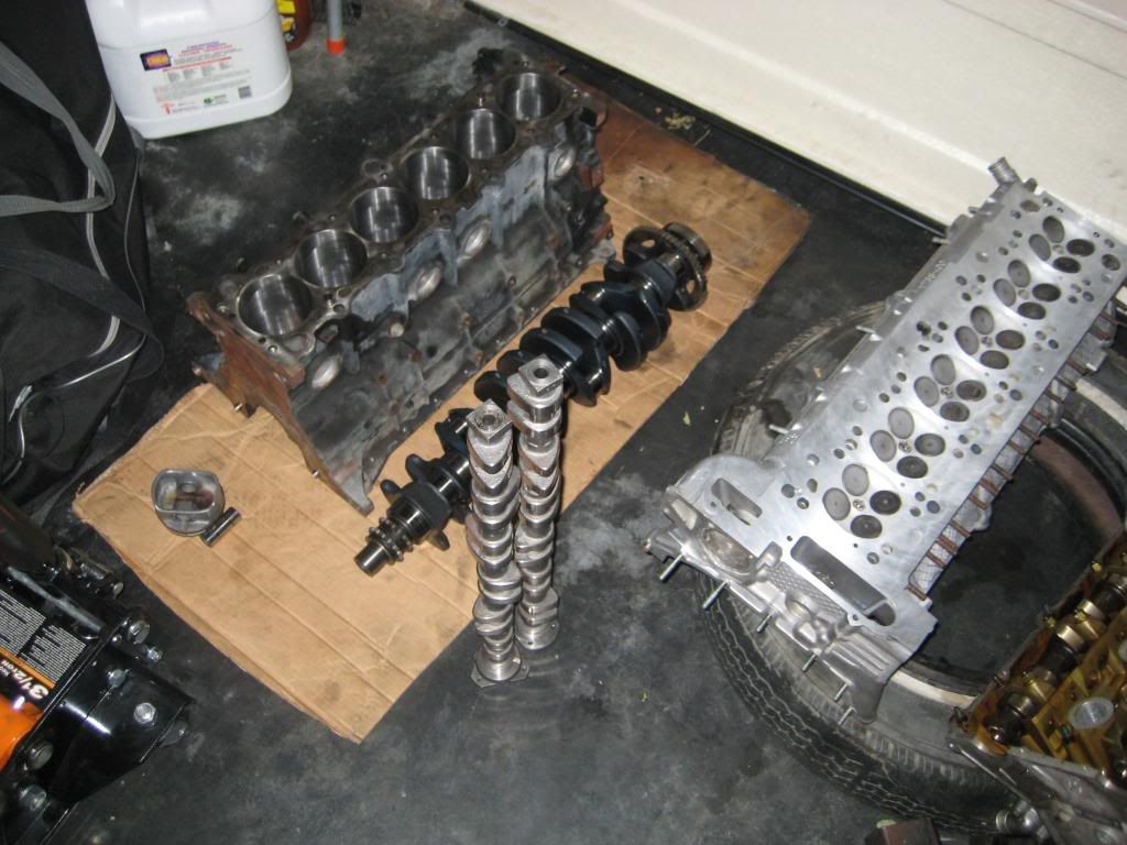

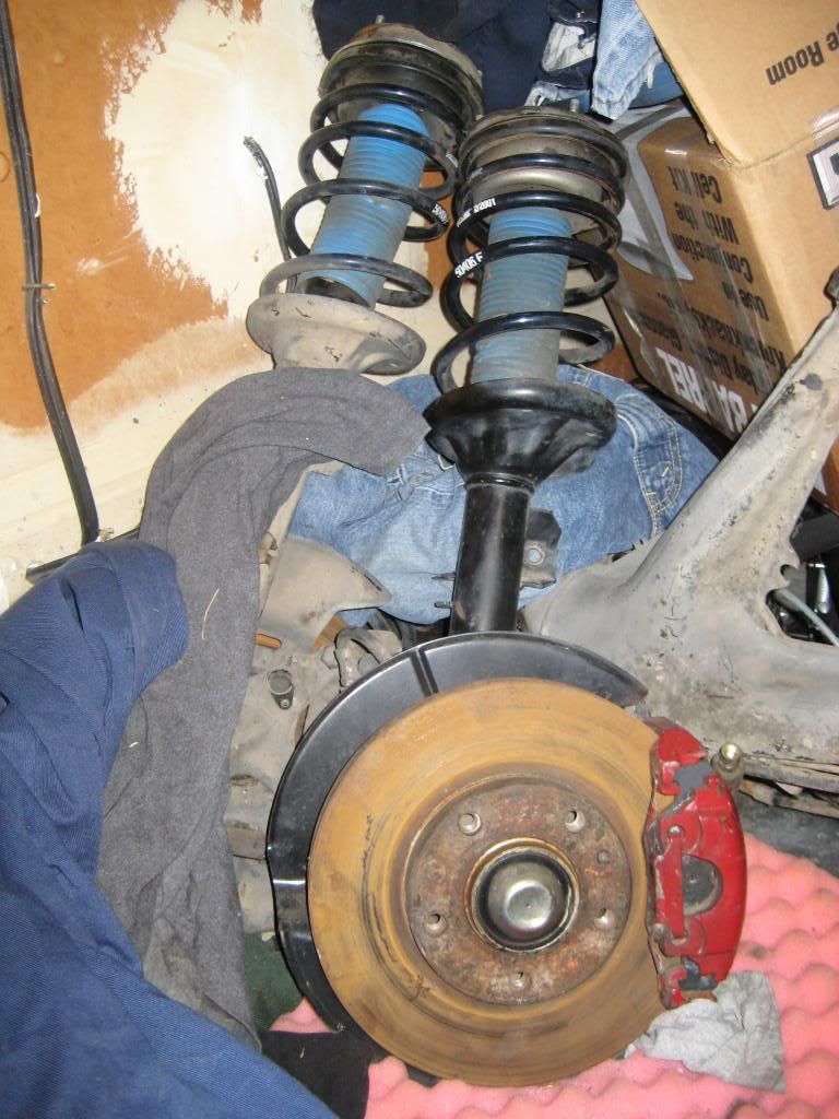

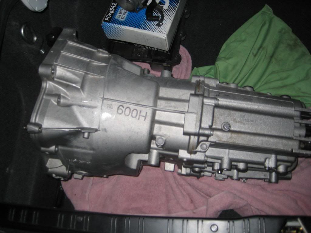

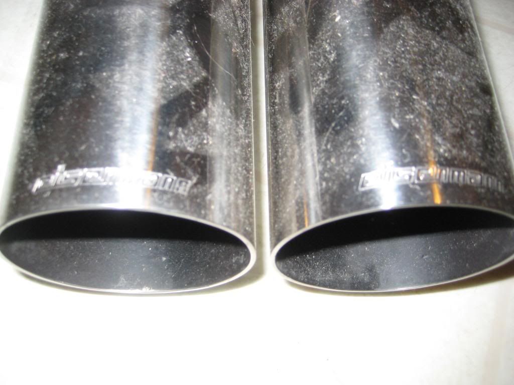

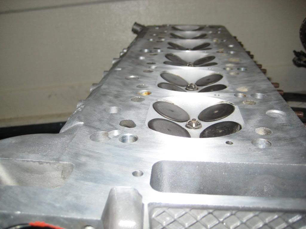

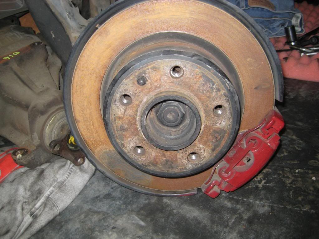

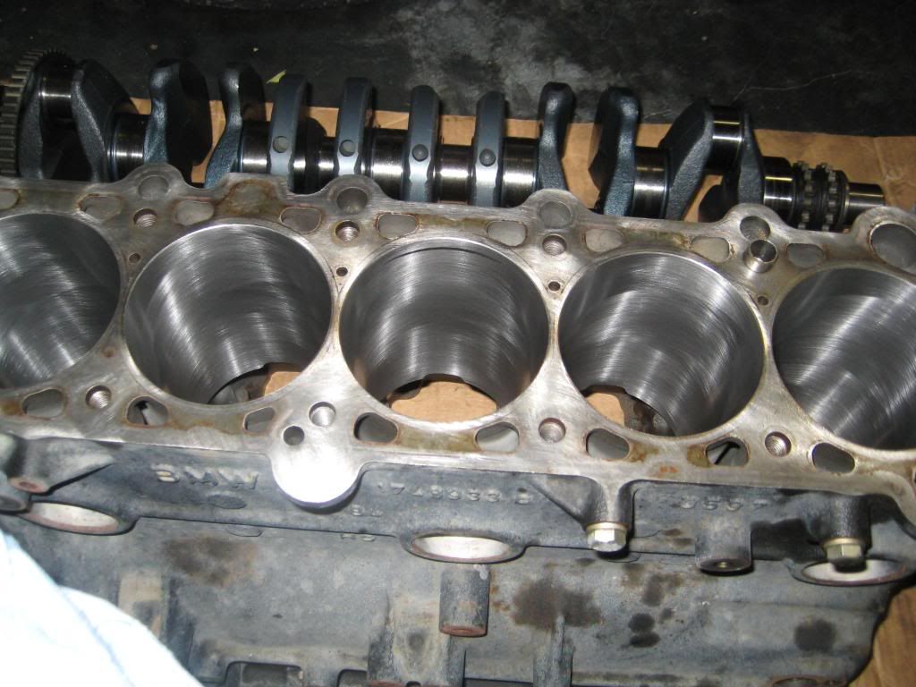

    This build is very similar to Mike30's build, but mine will be obd1. My first swap was awesome until the rings went out on the "70k" s52. So I picked up an m52, put m3 cams in it, and switched it out with the s52. That car is sold and I'm building another e30. For clarification this will be my seocnd swap car, but third engine swap. I didn't want to make a thread until I got the head and block back from the shop. Picked the head and block up today:D
    The build is still in the beginning stages, thanks to funds, so I'm just posting some of the exciting parts.
    S52 with 70,xxx miles

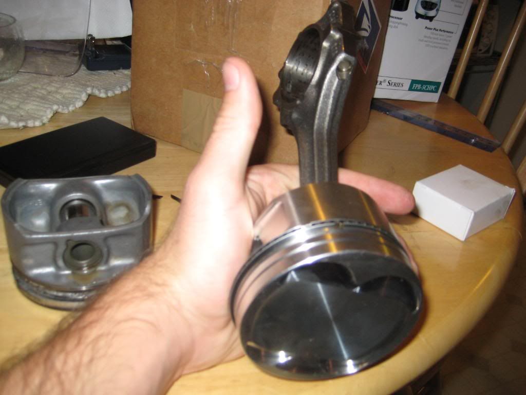

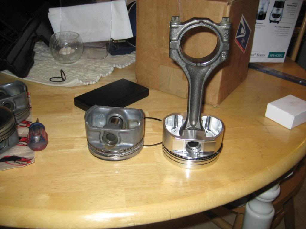

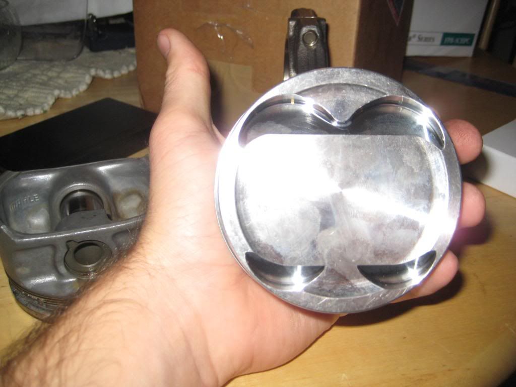

    JE Custom Pistons 87mm Bore 11:1 compression

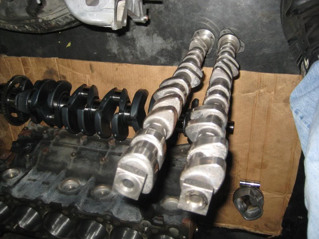

    Sunbelt cams

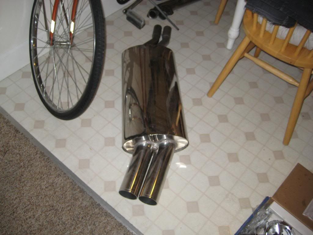

    Eisenmann race exhaust (for an e30)

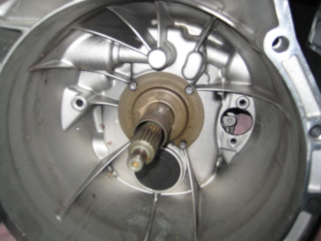

    2007 Z4m coupe 6 speed transmission

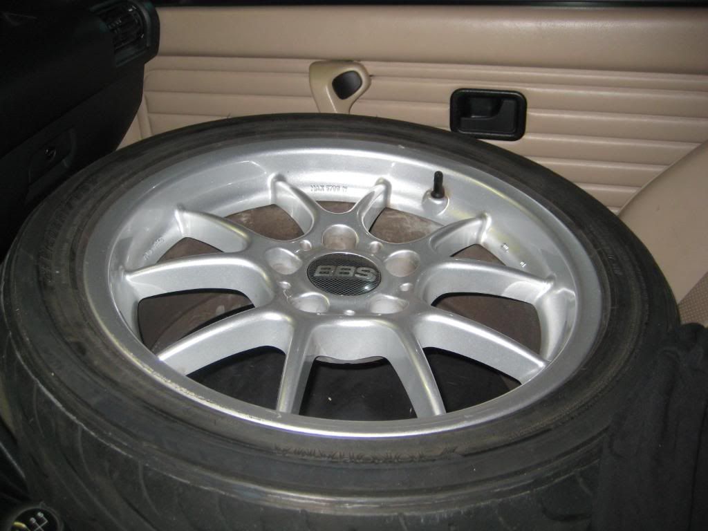

    E30 M3 5 lug
    BBS RK's 17x8
    a few pics

                What are the specs on those cams (can't eyeball 'em :p), and does this mean you found a replacement RK?

                  ride on, I'd appreciate it. Although I wont be ready for it until I order my flywheel/clutch for the six speed.
                  Originally posted by Wh33lhop
                  What's up Nick, how did I miss this?
                  Awesome man. Your car is going to be sick, wish I lived a bit closer.
                  280/272
                  I found someone recently that is selling a set for a decent price.

                      Hope your not leaving your crank stored like that...looks like an awesome build what kind of power are you expecting
                      • sharksforthecup
                        • Aug 2007
                        • 246
                        Engine is going back together next weekend. What do you mean?
                        I'll be happy with 270 to the wheels:pimp:
                        • SharpSpoon
                          • Sep 2009
                          • 6
                          cranks should always be stored on their end otherwise they can sag and end up out of round
                          • Mstngcobr761
                            • Apr 2008
                            • 557
                            This....was just going to suggest if you were storing it for awhile to put it on end
