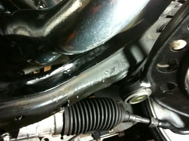

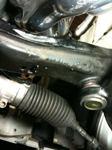

                    Update
                    pulled the engine back out and modified both the subframe and firewall.
                    Dropped her back in and now there is now plenty of clearance.
                    firewall
                    subframe

                        did you take off your swaybar, or is it just the angle of the picture?
                        • MIKe30
                          • Sep 2006
                          • 2334
                          #42
                          • sharksforthecup
                            • Aug 2007
                            • 246
                            #43
                            sway bar is still off. I'm gonna use the sway bar spacers that SUREBIMMER sells.
