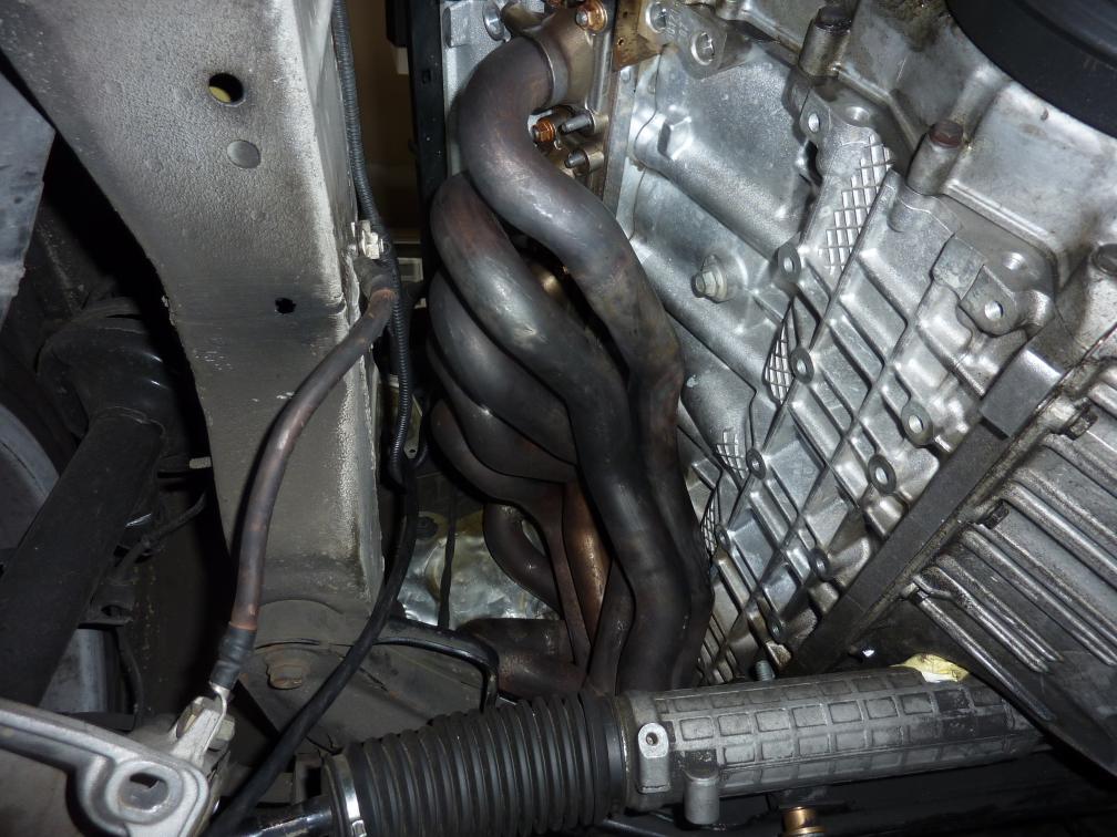

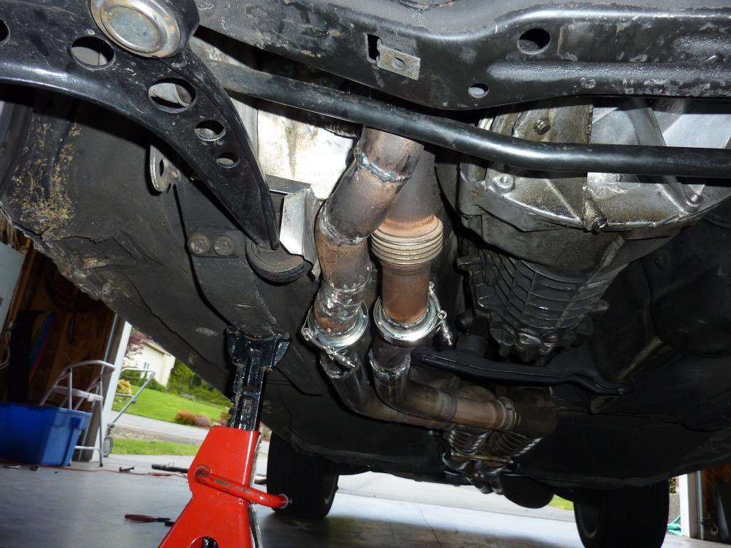

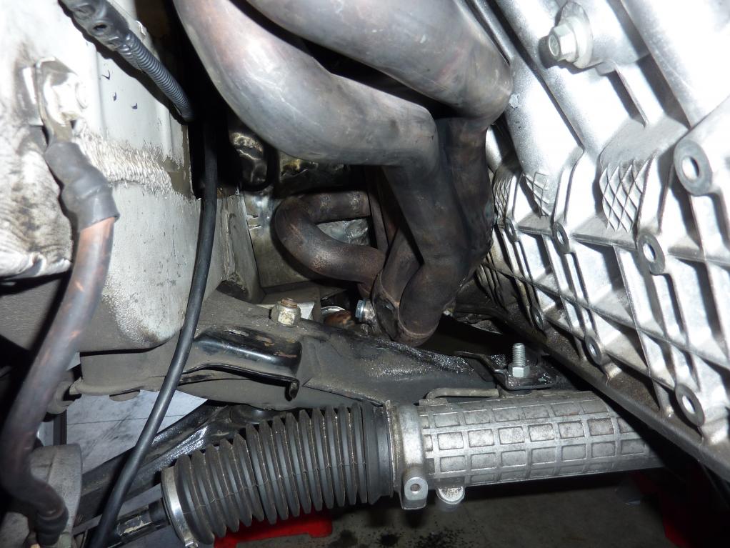

              euro headers installed
              These were quite the PITA to install.
              I re-routed #6 slightly to clear the firewall. The #1-3 collector was pushed up about 3/4" in order to clear the subframe and the sway bar. It clears both by about 5/16" with 1/4" shim under the motor mount.
              Also, the M54 block is physically larger and where these headers easily bolted onto an M50, they actually hit the block on the M54.
              The problem with the euro headers is that each cylinder has its own individual flange, they are not combined onto a larger flange plate like most other headers. If the pipe gets tweaked even just a little bit it won't line up any more and the holes are exactly M7 with no room for wiggle.
              Also, the port size of the euro motor is huge compared to the US DOHC motors and absoutely gynormous compared to the tiny M54 exhaust port!
              Driving impressions: sounds almost exactly like my exhaust with the OBD2 manifold, only slightly more gurgly. NO RASP. ZERO. These are quality stuff. Seems to pull slightly harder.
              A/F is a full point RICHER than it was with the OBD2 manifold. I've had to go a click leaner on my multi tune for WOT and it could probably use another click leaner.
              When I get my second car (e39?) I'll take them back off and have them coated.

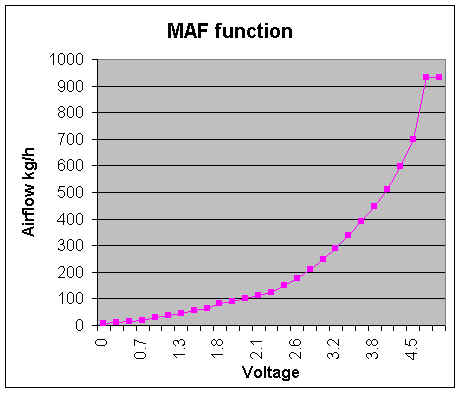

                              Tentative results from datalogging the MAF flow before and after the euro headers are that I have a slight bump in voltage. I went from around 4.25v at 6000rpm to 4.35v. I'll need to do a bunch of statistical analysis next week by combining multiple runs to get more accurate figures.
                              The MAF starts getting less linear at higher flows, so even a tiny bump in voltage correlates to a huge increase in flow.

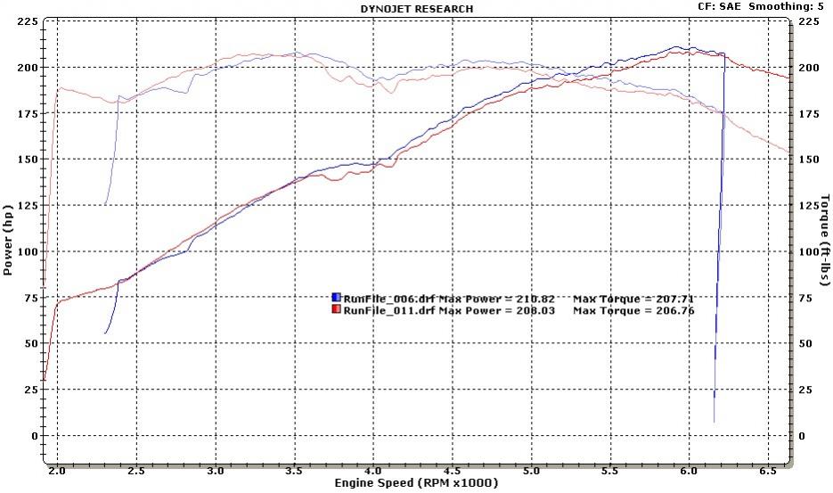

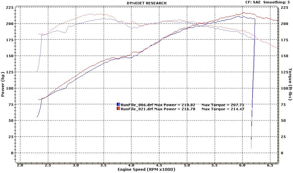

                              • hoveringuy
                                • Dec 2005
                                • 2700
                                header dyno comparison
                                This is euro headers vs OBD2 exhaust manifold, same exact tune. I actually lose a few horsepower. Could easily be difference in tire pressure, how the car was strapped-down, etc.
                                The good news is that the headers responded very nicely to tuning. They allowed me to retard the exhaust cam signficantly and they liked more fuel. Gains from around 2500 to 3500 are nice. OBD2 manifolds didn't like retarding the exhaust AT ALL!
                                Lesson here is that headers need a header tune to take full advantage.
