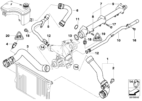

              Hey guys, a quick question for you all.
              I'm working hard on a plug and play system to drop S54's into older cars that I want to be as complete as possible. To be honest, the first harnesses I'm doing will be OBD-1 E36, but it will be a small jump to make a C101 instead of the X20... but here goes a question for the pro's
              Pin#4 – Br/Vi – Water temp – This is the signal wire for the e30 clusters water temp gauge. The e30 sensor should be grounded to the engine. The terminal on the sensor should be connected to a wire that connects directly to c101. From there it goes straight to the cluster temp gauge. This sensor is not used by the DME at all. For an accurate temp gauge the correct e30 temp sensor must be used.
              ************** Revised after getting the proper answer ******
              Thanks to board members for the answers.
              The sender for the E30 cluster is apparently grounded through the chassis which doesn't really yield what is considered an optimal set up for using coolant temperature for the DME's purposes of cold starts, temperature compensation etc....
              For E30 customers I will be offering a trade in for their core coolant manifold, my machine shop will TIG weld on a very professionally done bung for the E30 cluster temp sender. We'll use the factory S54 coolant sensor which is the two wire version in the stock location, and we've calibrated those already to have a proper temperature/voltage table.
              This will be relatively inexpensive, and unless directed to return the exact same manifold (ie, its pristine, you must have a pristine one back) I think I'll collect some, and have them ready to go, on the shelf as exchange items. Re-using the factory sender saves money too. I'll re-wire the harnesses to accomodate the E30 sender AND the S54 one. No biggie at this point.
              Sorry for the WOB
              Alex.

                Originally posted by M3 euro ltw
                I suppose for the E30 crowd, I could use the sender for the cluster only, and split the signal to the DME, and adjust its table??????
                (yuch, not appetizing)
                Not a big fan of that... I'd use a DME coolant temp sensor (obd1 sensor would be fine) in the port in the head, then find somewhere else to put the gauge sensor... Although it has to be metal, so it has a ground...

                Looking at that picture, I think I might put the gauge sensor #18 and the DME sensor to be in the #4 spot
                  [ATTACH]29368[/ATTACH]
                  That's a tough one.
                  DME sensor has to go at 18. DME needs an accurate signal for engine temp compensation before the thermostat opens
