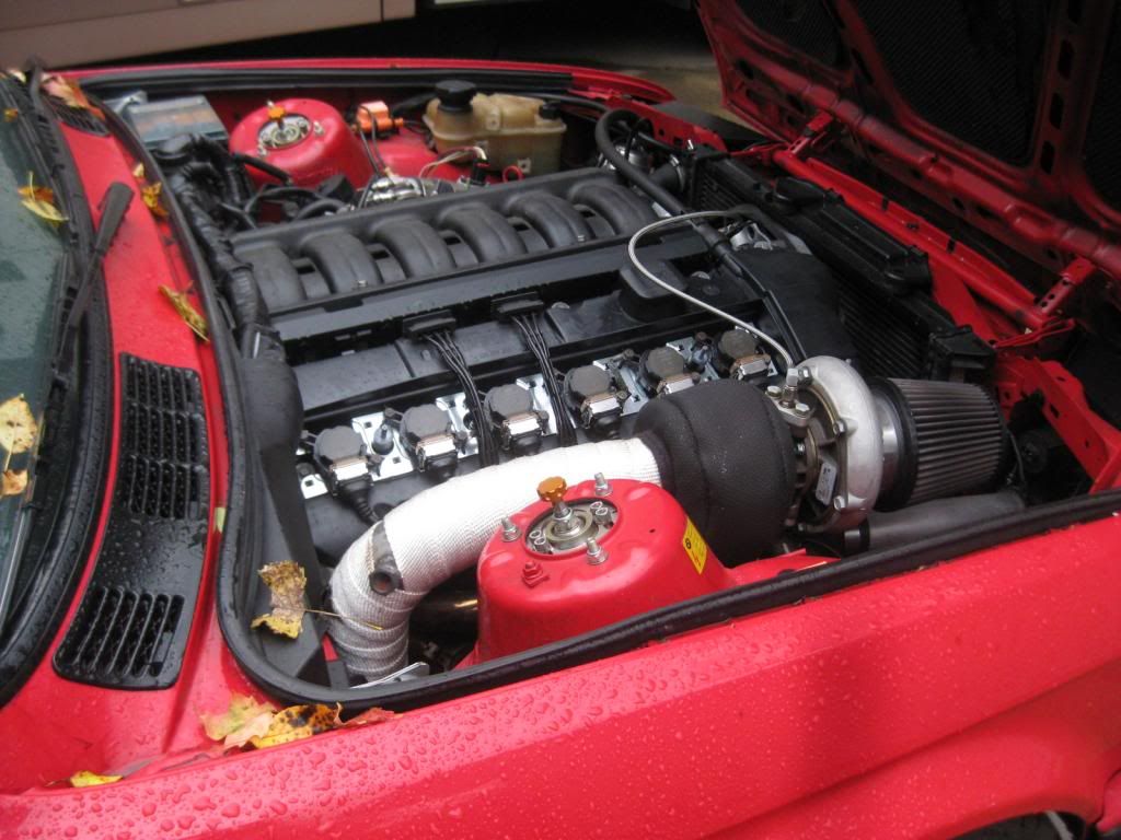

      Do these manifolds fit with AC at all? I have been searching for a picture of these manifolds installed on car with no turbo and can't really tell. Seems like it might work out OK...any comments appreciated!
      • blunttech
        • 12850
        #63
        Yes i have ac on my car Fits perfectly

          No mods need to be made to the line the runs near the strut tower? That would be amazing...do you have any engine bay pics?
          • blunttech
            • 12850
            #65
            No mods need to be made to the line the runs near the strut tower? That would be amazing...do you have any engine back pics?
            no it clears. What do you mean by "engine back pics"?

              Engine bay pics blunt lol
              Originally posted by bmwm42
              PNW vulture pm me for parts
              Strategic nw e30 command
              • blunttech
                • 12850
                #67
                lol yeah I can take some. Im going out there now anyways to clean the garage

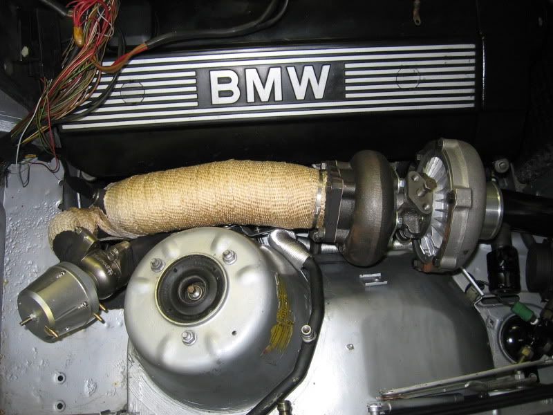

                  Sweet pic...where is the AC line???
                  • blunttech
                    • 12850
                    #69
                    lol I tore my ac out a month ago.. But trust me it fits fine... i had it in there for a year

                        Ok, sounds good. Thanks for the picture! What turbo are you running?
                        • blunttech
                          • 12850
                          #72
                          Garrett super 60
                            I designed these manifolds to work with A/C, so yes it will clear the stock line.
                            Here's a good pic with a/c lines. I brazed the E36 compressor outlet fittings to the E30 lines, worked perfect.
