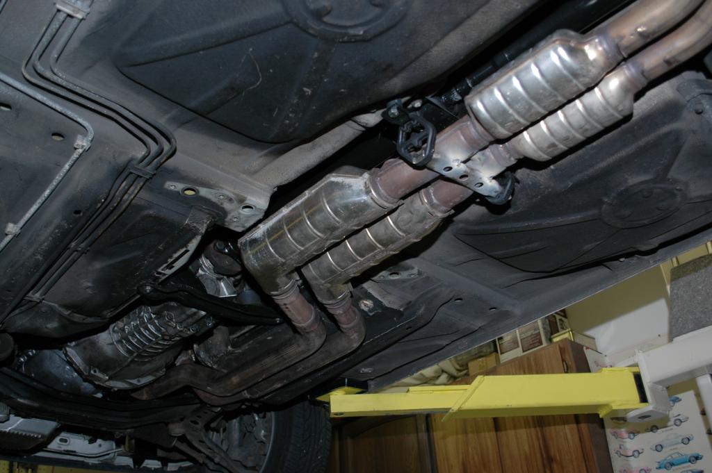

    I have this picture, which I think is a 325i exhaust.

      Maybe the obd 1 exhausts are different, but long tube headers+obd II exhaust doesnot fit properly. In thecase of obd II, although it could be used, the e36 exhaust will require it to be lengthened before the cats and shortened just before the muffler. The flanges will have to be cut off and relocated to just before that first 45 degree bend

          Here's how mine fit with OBD2 manifolds. I later switched to euro headers and just needed to cut another foot or so off the midpipes. Wasn't too difficult. OBD2 mids are better than OBD1.
                Yeah, I don't like how that brace isn't able to fit though. I'm thinking an E30 i exhaust. But I don't know how much room I have to play with to connect it at the front pipes.
                  Damn that looks like it was jammed up there high, lots of ground clearance, do you notice any loss in rigidity of the body without the middle cross brace?

                    It is way up there. It's on my list to fit the brace in there, I haven't noticed a difference, but I have a front subframe x-brace, too.
                    Eventually I want a track pipe just to save weight. I'm guessing a 2 into 1 merge after the headers with a single 2 1/2 all the way back would save around 40lbs.
                    The OBD2 stuff is HEAVY!
