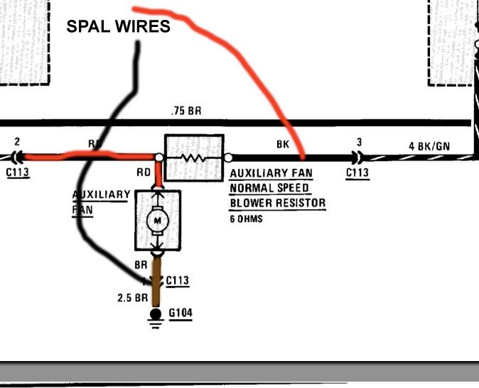

Why don't you want to you use the temp switch to control the fan? Get the 80/88 deg temp switch paired with an 80deg themostat, this is what I have and it works great. Then you don't have to worry about remembering to push a button and risk overheating.
If you want to run two speeds you can order the resistor and just wire it in yourself.
