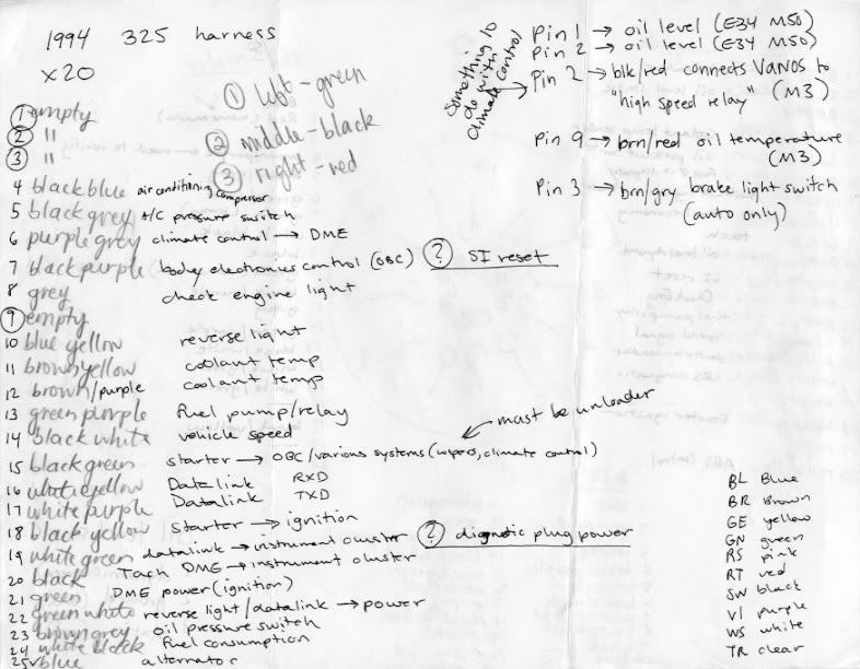

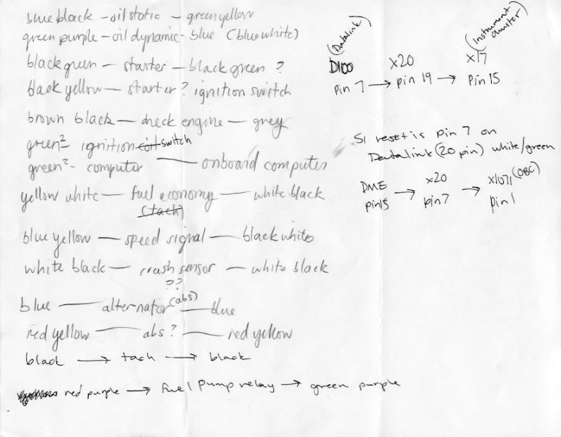

                here are some scans of my notes. i need to find some time to check everything again, in painstaking detail, otw i don't think i'll get this figured out.
                my wife and I created these pages using the bentley manuals and the ETMs.
                car is 91 325is, engine is 97 M3, harness is 94 325. i changed the x20 to c101. no adapter.

                  #53
                  Awesome.
                  Now do it not in cursive.

                    #54
                    Originally posted by ck_taft325is
                    Awesome.
                    haha, my plan with making all the notes was to make a PDF document that could easily be passed to future DIYers. i would obviously use a computer for that.

                      #55
                      That's awesome! you've done your homework.
                      Very few of those connections are actually needed for it to start. I think if you only had the crank sensor it would start, and with MAF, TPS run better.

                        #56
                        Hehe, I seriously appreciate that though.
                        Being a visual person, suddenly a lot of crap makes sense regardless that I've crawled around my S50. It really makes more sense with a drawing like such. Bravo, looks neato.

                          #57
                          oh wow. great notes!

                            #58
                            This drawing is really cool..... Do you have it in a higher res? I would make a large print and put it on the wall in my garage.

                              #59
                              i am a bit confused here.
                              x20 p7 . . . sw/vi . what did you do with this? its for the start imobilizer.
                              did your 94e36 x20 have (2) green wires or (1) gn and (1) sw/vi? your notes are conflicting. anyways.... if you have (2) green wires coming out of the x20, the second one (smaller) green wire on SOME harness is for the ews (drive away protection). this needs to be clipped or it will not start. might want to pull off the dme plug and check pin 66. green = drive away protection sw/vi = start immobilizer.
                              ews delete chip?
                              harness / dme from same donor?
                              just some thoughts.
                              cheers, jason
                              • hammslice
                                • 120
                                #60
                                Plan on further investigating immobilizer type stuff tonight. Harness and dme came together, pretty sure they were from the same car. Red label dme. Thanks for the thoughts.
