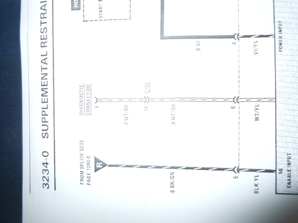

    did your 94e36 x20 have (2) green wires or (1) gn and (1) sw/vi? your notes are conflicting.
    The notes that mention two green wires was me tracing the colors through the stock c101 because not every wire maintains it's color from the engine to the body.
    Pin 66 on the dme is SW/VI. What kind of signal/when is this wire looking for?
    I think this is where I goofed. I have the immobilizer SW/VI hooked up to SI reset BL/WS. And SI reset WS/GN hooked up to WS/SW. Speaking in the direction from motor to body. Hopefully I can swap these after work and give it another go.

            #65
            That would totally be consistent with the problems you're having. It's been done many times before.

              #66
              SI reset is now in the correct place.
              Start Immobilizer is now in pin 16 but I'm not sure I fully understand this. I rechecked the ETMs and E30 Pin 16 goes between the diagnostic connector and the SRS module.
              RealOEM.com puts my DME from a car with a build date of 10/1993, so EWS should not be an issue.
              Still no start.
              I'm working on checking continuity and haven't come across any that don't make sense as of yet.

                #67
                i spent the night redoing my ETM research. i did it based on build date, pretty sure i used model year before, to see if it made a difference. i got the same result.
                C101 pin# Wire Color (E30 Chasis) Function Wire Color (E36 Engine) x20 Pin #
                1 Blue Alternator Blue 25
                2 Blue/Black Oil Lvl Static Red (Homemade)
                3 -- --
                4 Brown/Purple Coolant Temp Brown/Purple 12
                5 Black/Brown Oil Pressure Brown/Grey 23
                6 Green/Yellow Diagnostic Power/O2 Heater/Fuse 9 Green/White 22
                7 Green Switched Ignition/OBC Code Relay Green 21
                8 Yellow/White Fuel Economy White/Black 24
                9 Black Tachometer Black 20
                10 Purple/Green Oil Lvl Dynamic Green (Homemade)
                11 White/Blue SI Reset White/Green 19
                12 Brown/Black Check Engine Grey 8
                13 Purple/Red Fuel Pump Relay Green/Violet 13
                14 Blue/Yellow Speed Black/White 14
                15 Black/Green Starter Unloader Black/Green 15
                16 White/Black SRS Diagnostic/Not Used ??
                17 -- --
                18 Black/Yellow Starter Ignition Black/Yellow 18
                19 -- --
                20 Red/Yellow ABS
                x20 Pin # Wire Color (E36 Engine) Function Notes
                1 -- E34 Oil Lvl
                2 -- E34 Oil Lvl/E36 M3 A/C VANOS control
                3 -- Brake Signal (Auto Only)
                4 Black/Blue A/C Compressor Control
                5 Black/Grey A/C Pressure Switch
                6 Purple/Grey DME Climate Control
                7 Black/Violet Start Immobilizer
                8 Grey Check Engine Light
                9 -- M3 Oil temp
                10 Blue/Yellow Reverse Light Signal
                11 Brown/Yellow Coolant Temp 2
                12 Brown/Purple Coolant Temp 1
                13 Green/Violet Fuel Pump Relay
                14 Black/White Speed
                16 White/Yellow Data Link RXD
                17 White/Purple Data Link TXD
                19 White/Green Service Interval Reset
                20 Black Tachometer
                21 Green DME Power
                22 Green/White Reverse Light/Data Link Power
                23 Brown/Grey Oil Pressure
                24 White/Black Fuel Consumption
                25 Blue Alternator
                1990 332is - work in progress.
