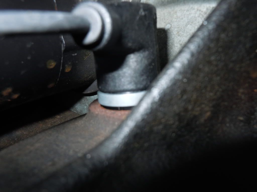

        I checked out the sensor tonight and it definitely wasn't flush. The M44 sensor came with an O-ring and it's a different O-ring than the S52 Hall effect sensor uses, not surprisingly.
        I removed the O-ring and reinstalled the sensor and it sits flush now, but it still won't start.
          Damn... I thought that was going to have a happy ending. Is cranking now causing the fuel pump to kick-in (power at fuse 11) or is it exactly the same as before?

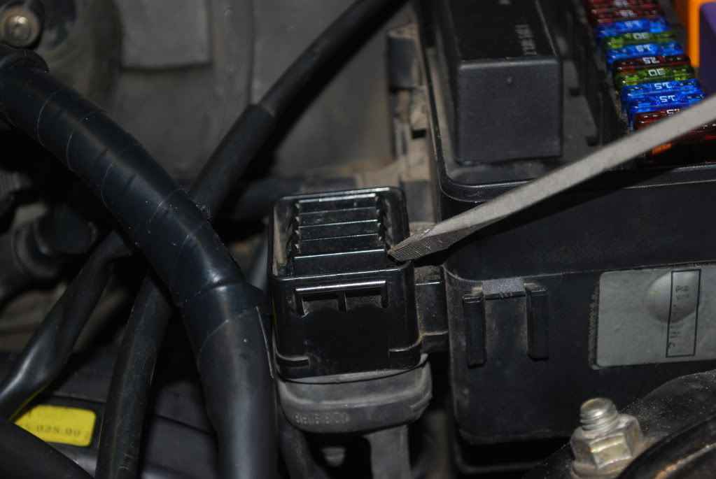

              Do you, or anyone, know what this is? Its next to my fuse box, never had any cover or anything plugged in, and I didn't see it in any pictures in the Bentley manual. Haven't tried to trace it yet.
              Grasping at straws now.
              1990 332is - work in progress.
              • accident
                • 7303
                #37
                auxilliary fuse box. one wire is constant and the other is switched.
                  Just an auxilliary plug. Doesn't do anything.
