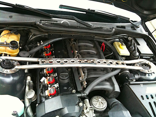

                            I asked the same question and acted upon it a couple motors ago:
                            S52 car with M50 nonvanos HEAD + ADDED VANOS.
                            basically. keep the vanos, keep the S52 cams and S52, gain thicker valvestems (for durability not performance) and get free double valvesprings.
                            single beehive S52 valvespring is lighter, etc and more advanced.
                            BUT the dual valvespring M50 NV has a better chance of fighting coil bind at very high RPMs.
                            S52 is best used 100% out of the box obd2, or done up OBD1 with chip tune. Other than that, its a waste of money.
                            M50 family is economy motor, dont expect it to be a S54.
                            for real power, S54 is THE ANSWER.
                            old S52 with Nonvanos head installed:
                            S54 real power installed:
                            basically, do the math:
                            S52 swap (parts 3k)
                            s52 NA bolt on mods $3k easy (1.5k cams, .6k chips, .25k intake, .6k exhaust)
                            then u have a 6K S52. guess what; S54 costs the same and will walk you :) and will walk dyno tuned catless STi's on the freeway on 5 cylinders.
