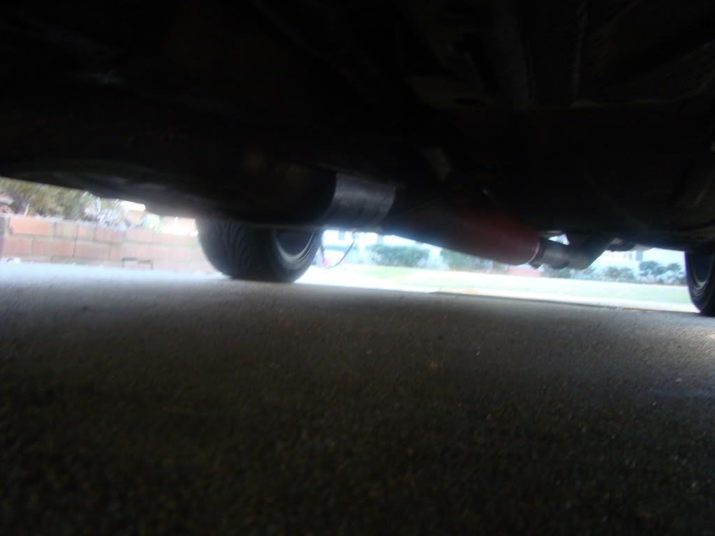

              I got the biggest resonator i could fit and threw it under there. Worked great!\
