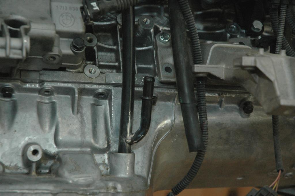

    Did you have to do anything to make that OB2 dipstick fit in the e34 oil pan?
        I did the this by grafting onto the e34 dipstick. It works well for the most part, but has a known issue of grenading the engine in cold temperatures. The CCV will freeze causing the engine to suck oil out of the pan directly into the intake.
        • samiam3356
          • Jul 2009
          • 1901
          Yeah I'm in Atlanta and the car stays in the garage so it wouldn't be too much of an issue for me. I'm not getting much blow-by right now but if and when I do I will probably go a different route and use one of the air oil seperators that some of the track guys use.

          • 328ijunkie
            • May 2007
            • 3961
            I run this on all OBD2 cars, The OBD1 system is garbage and you get oil pooling in the intake manifold and running a open CCV is a bad idea as well.
            As far as it freezing goes, IIRC that is isolated to E46's.

            • alpinescott
              • Apr 2011
              • 114
              Icv?
              What have you done with the ICV when using the OBDII "funnel"?

                • 328ijunkie
                  • May 2007
                  • 3961
                  What you mean? Im currently using Eric off BFc's M50 manifold adapter kits
                  Photo is on my facebox.
                  Originally posted by I*Do*Werke
                  what do you mean by "blow-by"?
                  So what is the best method for using the oil separator on an obd1 car?
                  Instead of using the factory OBD2 VC hose youd just have to make one. Thats the only difference
