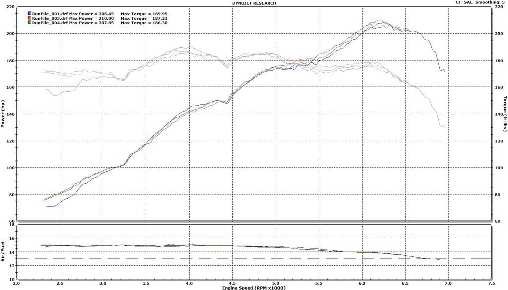

                        I found this dynojet plot for a stock N52. I think with a better exhaust you could easily add 10 but still not that powerful. It's interesting to see the multiple torque spikes with the 3 stage DISA.

                          What N52 is that? Isn't there like 5 different version of that engine in various models? Are all US cars 3.0 liter?
                            It's a motor that someone converted from the 2.5 specs to 3.0
                            All US N52's are 3.0 litres, even the 2.5 versions. The difference in the 2.5 is a crappier 2 stage intake and detuned software. I'm guessing that the magnesium/aluminum block production process couldn't be economically duplicated in two sizes.
                            The best N52 version is rated at around 268 bhp which would be around 215whp. Makes sense.
                            I do appreciate the light weight and great torque my M54 has and I imagine the N52 would be even better.
