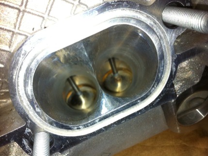

                    sorry for the crappy iphone pics, camera batteries charging

                      I had asked him to post some pictures of his N52 head because I have heard that the ports are CNC'd like the S54.
                      S54 Intake port = 275 CFM
                      M54 Intake port = 200 CFM
                      N52 = ??
                      M54 "D" port heads for comparison, 50x27mm. I've heard that in order to make the M54 intake flow well material needs to be added to them, they're TOO open.

                        Nice looking ports. I bet it flows well since the power doesn't drop off till after 7k.

                              Those ports are so sexy - very very awesome! Interesting that the fuel injector port is cast into the head - means that N52 intake manifolds can't be used on M50/M52 motors even with an adapter plate! :(
