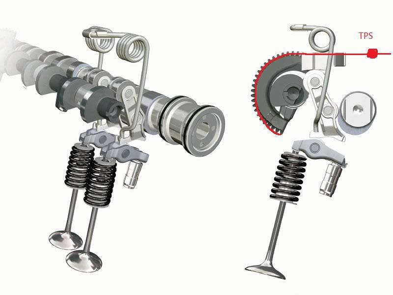

                Pondering here. Why can't the valvetronic be actuated my accelorator cable? In the same way it dose with a throttle body. The geared lever is the same shape. Would have to fab up one with a valley for a cable.
                The things to consider is sealing the wire when it enters the cam cover? How to position a return spring? Mounting a TPS? Mind you this all depends on how easy it is to turn this thing.
                That way as far as an after market ECU is concernd it is buisness as usual?
                Well that is how I would do my swap anyway.

                    #69
                    because it's based on load/rpm/temperature, not just throttle position (that probably has some play too).
                    AFAIK, the N52 has no throttle. it actually opens the valves less instead, for idle, cruise, etc.

                            #73
                            I don't think you quiet understand what I mean.
                            The red line would be your accelerator cable and the red dot being a TPS. This way you can still use the valvetronic on a something like MS. All the while MS still thinks you are using a throttal body with a TPS.
                            I though the big issue with the new motors not working on aftermarket ECU is because of teh Valvetronic?

                              #74
                              no, I do. you're saying control the valve opening with a throttle cable. the problem is on the factory engine, throttle position is only one element. engine load, RPM, and temperature are what really control how far it opens the valves.
                              it would "work" but driveablitly would be pretty poopy. 50% throttle isn't neccesarily 50% load, and you don't want to operate them the same way when the engine is cold as when it's hot. you'd be better off just locking the cams.
                              if it's a PWM controlled solenoid of some sort, MS3 could probably control it. the problem is they won't add support for the E-throttle.
                              really though, why not just use the stock ECU?

                                #75
                                Oh ok I understand now valve lift to power out put is not linear. Makes more sense now. Yeh locking the cam and running itbs seem easier. I don't like the stock ECU because of its limited tuning. But is a work of art non the less.
