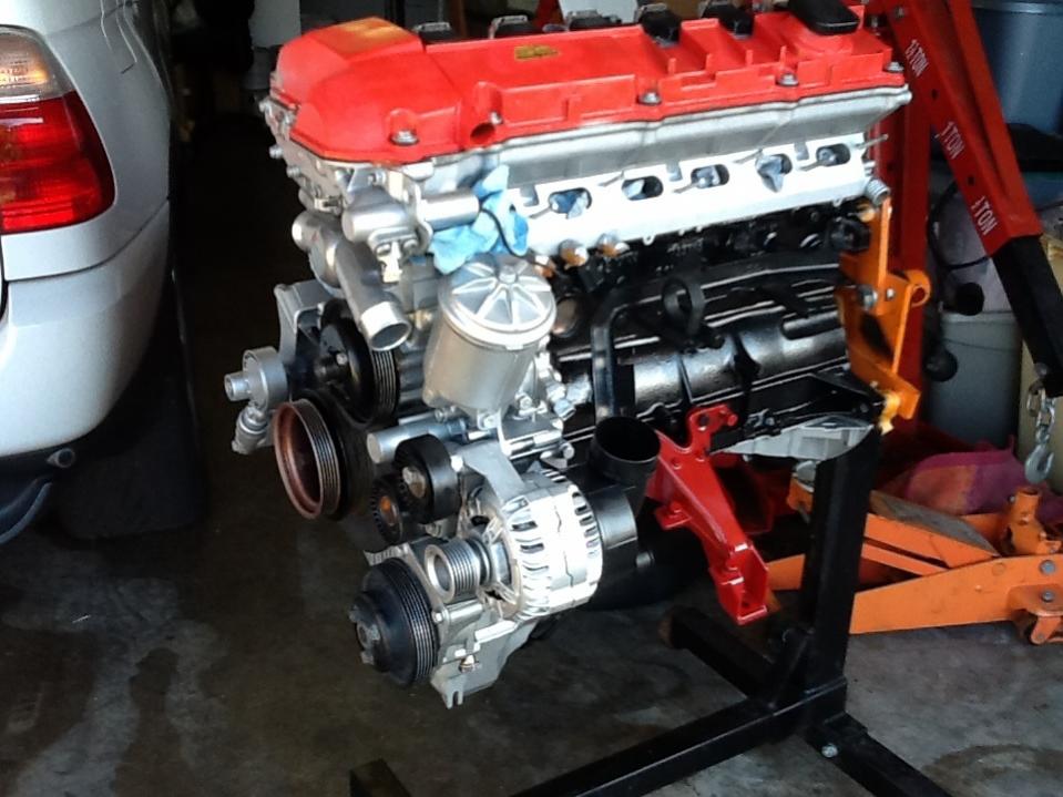

              Some progress today
              • amcink
                • 788
                Some more
                • amcink
                  • 788

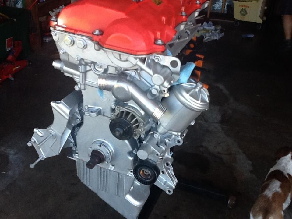

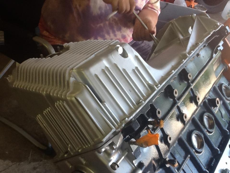

                  More progress, oil pick up, oil pan, oil housing and ac bracket are on
                  • amcink
                    • 788
                    Oil pan

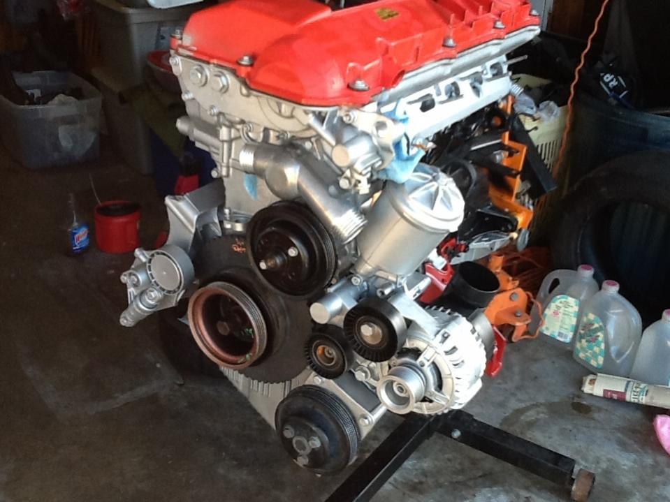

                        So i'm done preparing the engine outside and is ready to be swapped and then finish once is in the car
                        • amcink
                          • 788

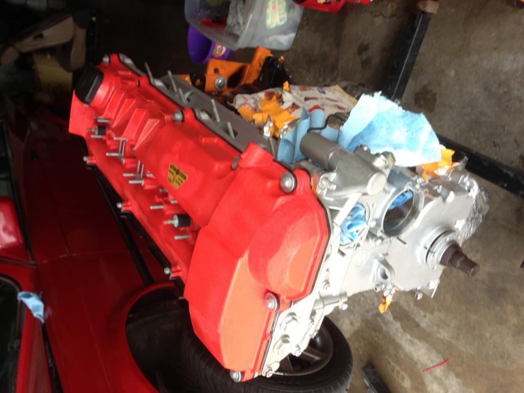

                          This is ready to go in

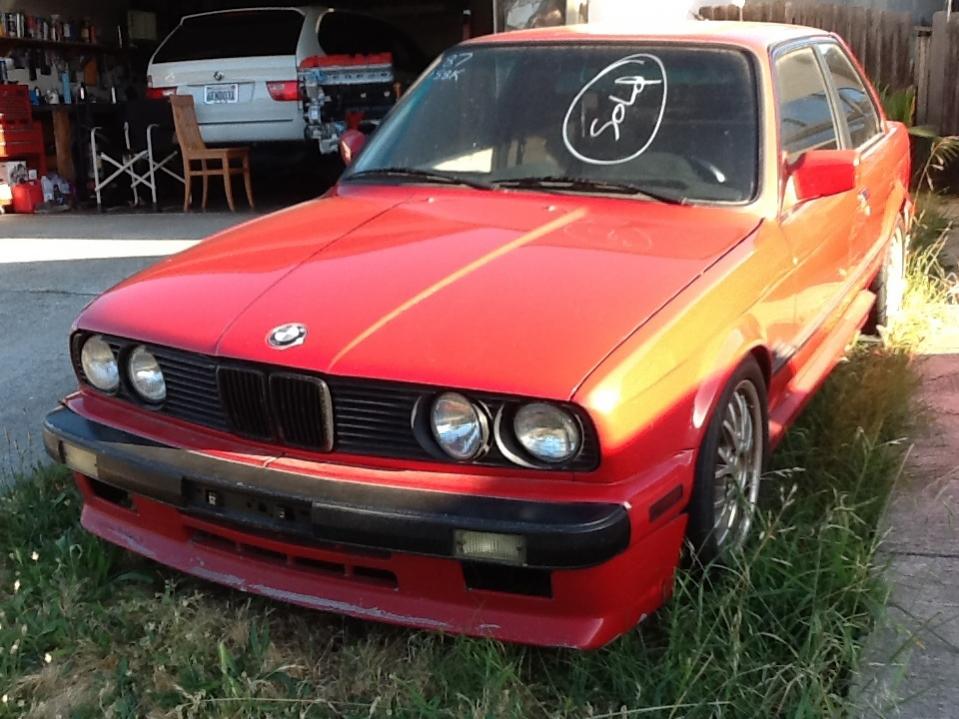

                            The recepient ( needs minor tlc)
