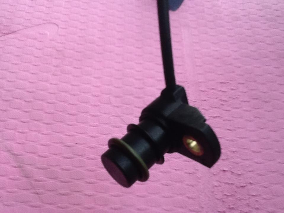

            Originally posted by emmanuel.dlc
            on the cam shaft sensor, which oring you used?
            Emmanuel
            I used the non vanos oring. I took it off the non vanos cam sensor and install it on the vanos sensor. It fits good only when i screwed back the sensor be careful since it fits tight once the bolt is all in.
            Attached is a photo to compate the oring sizes NV small Vanos green ( too thick)

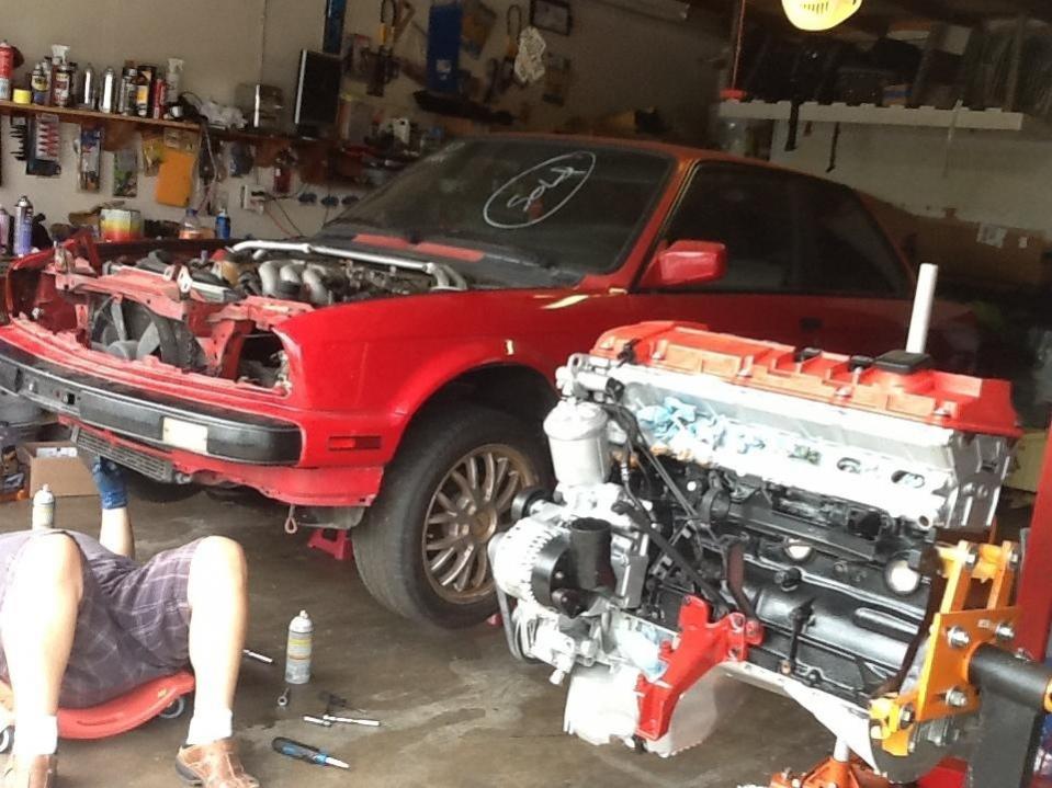

                And the surgery begins!!! Should be ready in 2 weeks (due to my work schedule)
                • amcink
                  • 788
                  #38
                  M20 is out; another step closer to the M50
