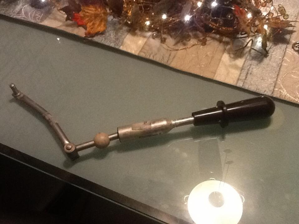

      I've stoped my swap.due to financial reasons; however i'm back on track and just picked up my new short shift set up.
