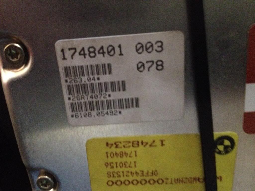

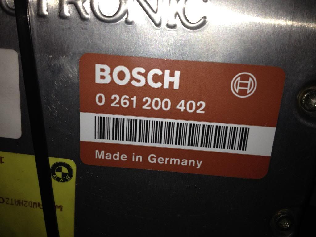

        Pictures of both?

              Hope this helps
              E30/ 318i m10, e30 m50 & E34/ 520i m50
              • M-technik-3
                • 18946
                Wrong ecu for that engine.
                • Nick_S
                  • Apr 2011
                  • 3655
                  That is definitely a 402 for a non-vanos.
