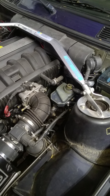

                        Originally posted by martijn76
                        -Year and model of your E30: 1991 316i
                        -Intake manifold used in swap: M52B28
                        -Brake booster donor car: Porsche 944
                        -Brake booster part number:
                        -Brake booster manufacturer and manufacturer PN or identifying marks: Stock Porsche, ATE brand
                        -Modifications needed: Rod must be cut to size then rethreaded.
                        -Comments on pedal feel and stopping power: I've swapped the 325i front calipers for Porsche Boxter brakes(968 ), the pedal feels like stock, the stopping power is so much better.
                        where do you get that neat wiring harness cover? Looks clean.
