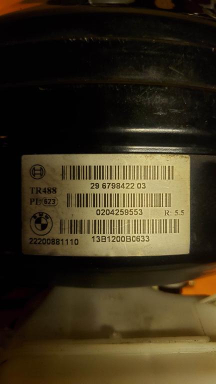

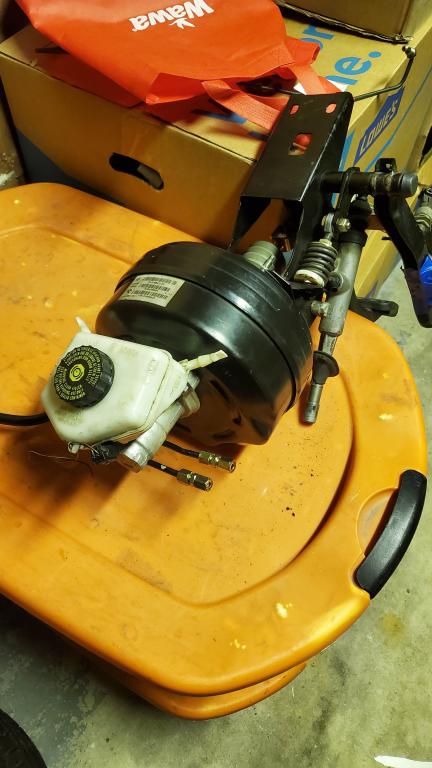

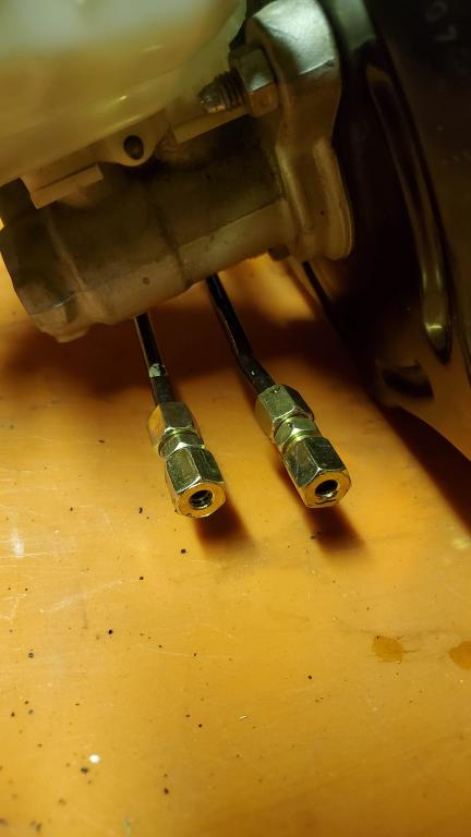

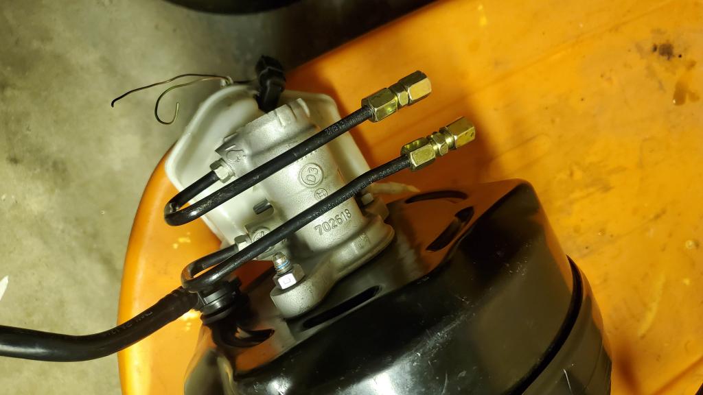

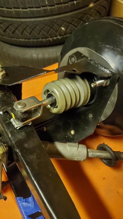

            -Year and model of your E30: 1991 318is
            -Intake manifold used in swap: m50 OBD1
            -Brake booster donor car: 2009 e90
            -Brake booster part number: (if known)
            -Brake booster manufacturer and manufacturer PN or identifying marks: stock e90 booster
            -Parts needed: no parts needed, used e90 booster and master cylinder
            -Modifications needed: used the U-shaped e30 booster pedal bracket and welded it to the U-shaped bracket on the on the end of the rod on the e90 booster. It ended up being an exact fit. No cutting or re-threading needed. I did have to shave down a couple of fins on the intake manifold as they were almost touching the booster.
