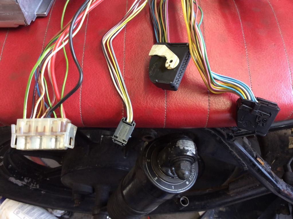

                    Can you make PNP connector for m52b28 from auto 728i e38 OBD2 (I think) that has diffrent connector (not x20 see pic) to my 89 320i e30 c101 manual transmission with AC and oil level sensor and NO ABS.
                      Does the motor have any VIN sticker on it? Looks like it would be the m52tu with the double vanos, correct?
