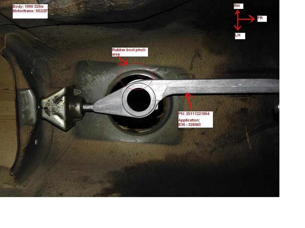

            Here's a pic of my ZF trans with the e30 shift carrier.
            You can tell from that the pic that the e30 carrier isn't ideal.
            I'm getting a e36 carrier. Just thought this might help someone else.
            Here's the e36 carrier, its centered better fore/aft but side~side is a little off.
            With the shifter installed the shift lever pinches the rubber boot (pn: 25111220912) when going into 5th, this is with the MZ3 shift lever (pn: 25117527254). Its not enough to keep you from engaging 5th, but you can feel the drag on the shift lever.

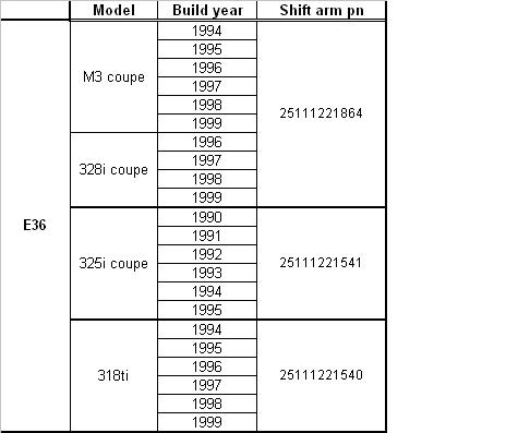

                  Here's comparison of the e36 shift arm pn's from realoem:

                    #39
                    So, all M3s used the same carrier. Based on my carrier I'm guessing the one pictured above is not from an M3, but it appears it may be the best fit.
