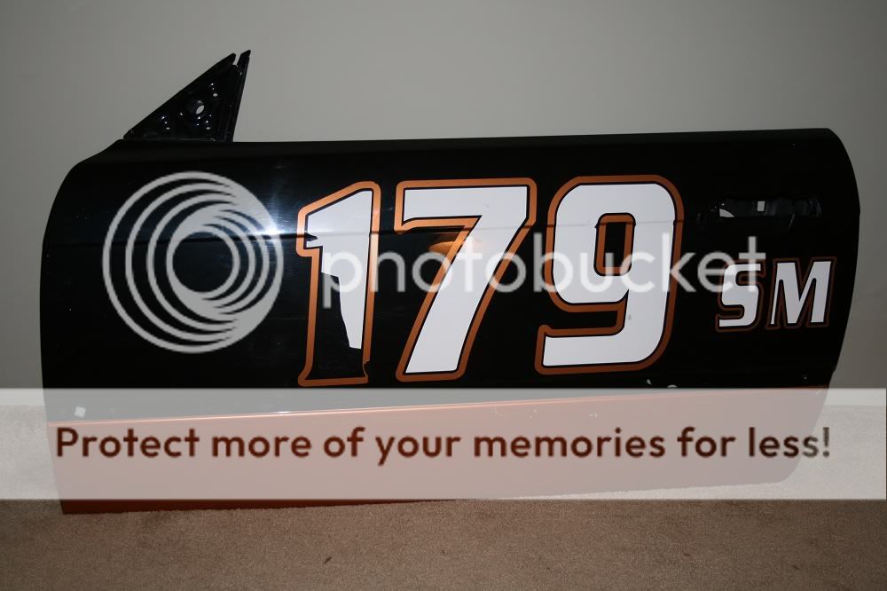

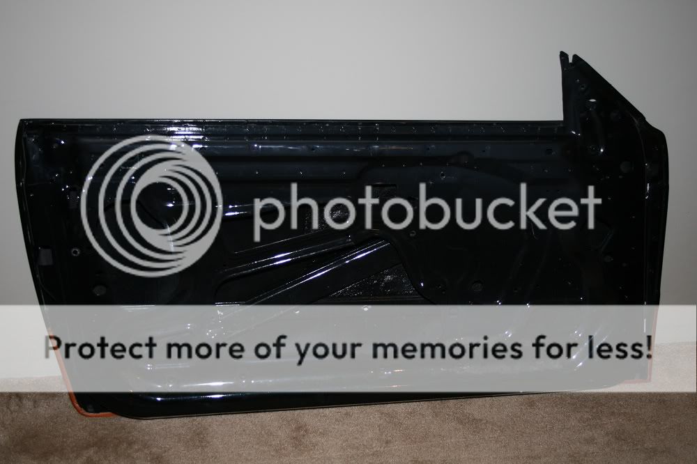

                    • Jaker
                      • Oct 2013
                      • 234
                      Originally posted by Bimmerman325i
                      The real trick parts on the LTW were the aluminum doors.
                      Yup. 20lbs instead of 35 (or was it 15 instead of 30, can't remember now) for the bare door. Mine came from the M3 Evolution in the UK.
