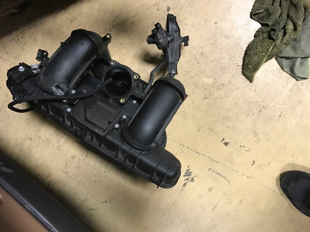

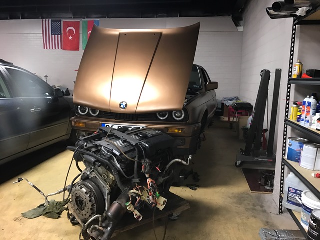

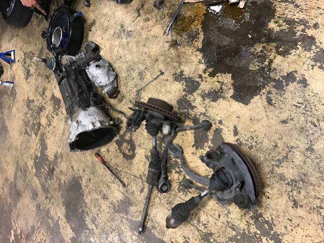

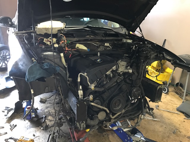

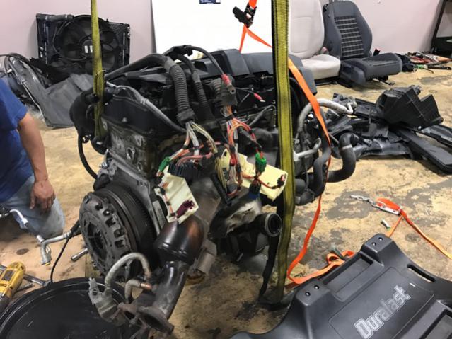

    Starting N52 Swap.
    Hello everybody dreaming of swaping a n54 for long time i ended up getting a complete 328xi manual. i actually bought the car for body parts with not running condition. when i went to pick up all it needed was a jump start. after parting it out, i removed the engine, and last week i found a good deal for 6speed removed from a e90 328i, and a msv70 since they are easier to read and write.
    and old transmission for sale.
    Now i need your help on picking right oil pan,
    fueling, (pump regulator lines ect)
    solving no cluster issue.
    and engine mounts.
